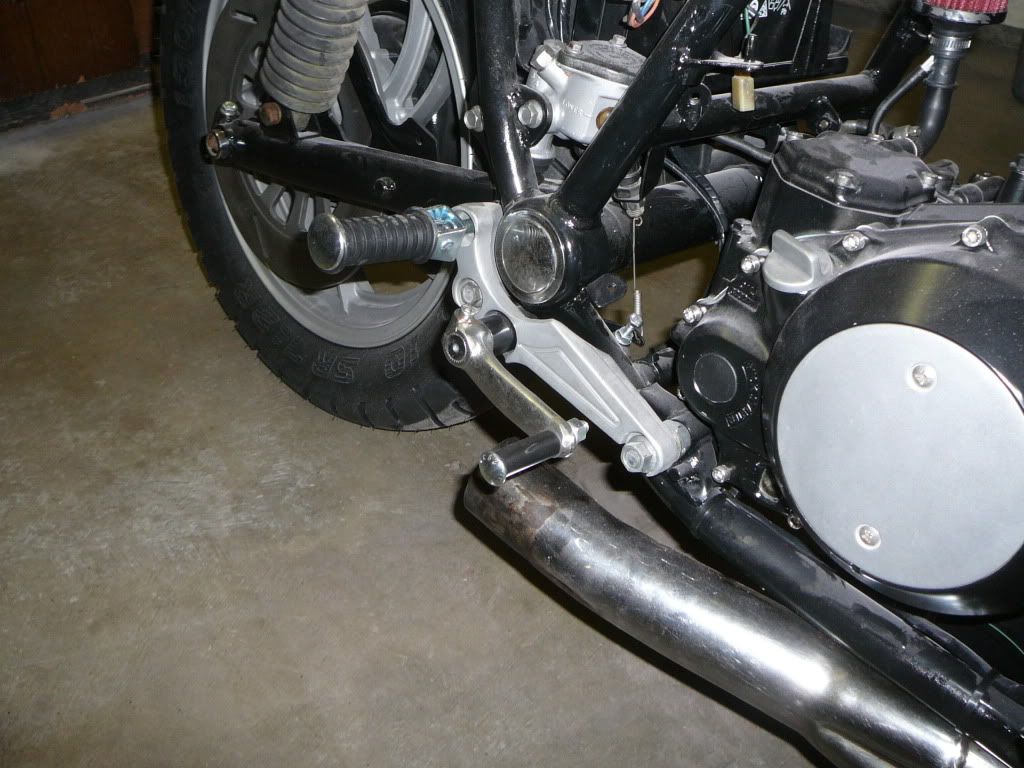

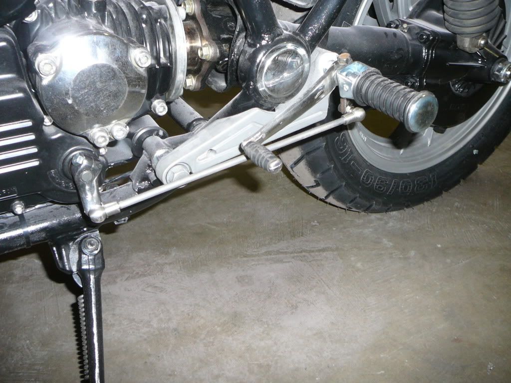

    I ended up making some "rearsets" for under $20 at my local hardware store, (and place of work) Ill post pics soon.
  12. ST0CKM0NK3Y
    ST0CKM0NK3Y Member
    Berkely Michigan
    I had to extend the shifter linkage, it was very simple and only cost me about 12$.
    then i flipped the linkage for the brakes so it links backward to the pedal. I mounted the pegs through the holes for the muffler mounts. Im waiting on a welder to tack them in place but other than that what do you guys think?
  13. Orange-n-Black
    2,210
    Memphis Area
    Good work, nice and clean. :twisted:

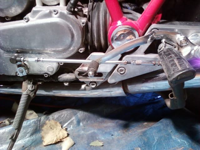

  14. stevestrom
    stevestrom Member
    58
    I did something similar to yours on my xj1100. Peg mounting points are a little different on mine though. Total cost was around $20.
  15. stevestrom
    stevestrom Member
    58
    Any idea why I can't post pictures, I must be doing something wrong. :(
    Here is a link
    Here is the other side
    This is the best I can do til someone tells me what I am doing wrong.

  17. ST0CKM0NK3Y
    ST0CKM0NK3Y Member
    Berkely Michigan
    I know you have to use the IMG code if your using photobucket. but yeah man, i like your shifter link. How did you make it? or did you buy it? Also are those aftermarket brake and shifter levers? I really like how it looks.

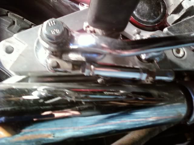

  18. stevestrom
    stevestrom Member
    58
    OK Ill try another pic here
    Still not sure what I am doing wrong. The process that I use on all other forums does not seem to work here. Oh well, I guess no pictures for you guys, only links.
  19. stevestrom
    stevestrom Member
    58
    I made the set up. Threaded some 1/4" steel rod that I cut to the appropriate length. Added the ball and socket fittings on the ends. Cut about 2/3 off the original shifter and put it on the bike facing down and attached the ball and socket joint. The shift lever that is on the footpet is out of the junkyard (no idea what bike it is off of). I used the rest of the shifter and had a guy weld it to the bottom of the junkyard shifter. Attached that end to the other ball and socket and called it done.
    As for the brake lever. That's just the stock lever cut down, drilled a hole and put a bolt through it with a piece of rubber.
  20. ST0CKM0NK3Y
    ST0CKM0NK3Y Member
    Berkely Michigan
    I see, good idea on threading the rod, i went the easier route and bought pre-threaded rod and then slid a peice of 1/4 stainless steel tubing over it to provide strength. It shifts through all the gears great in my garage but it still needs a road test. :D
