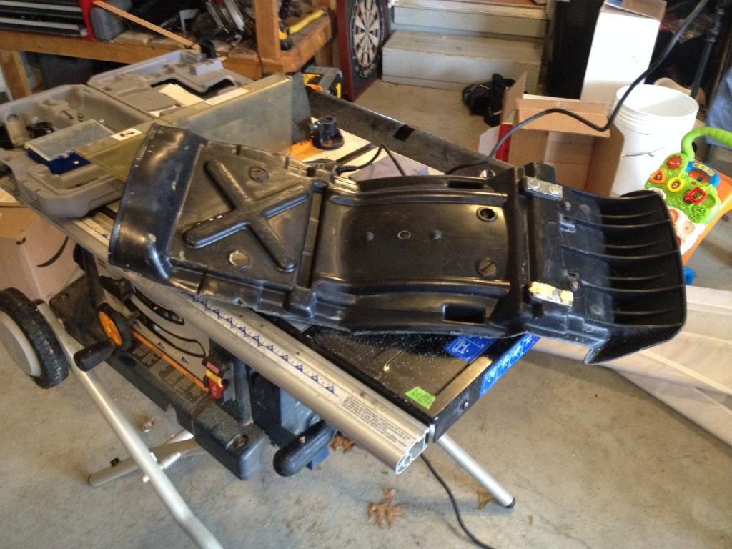

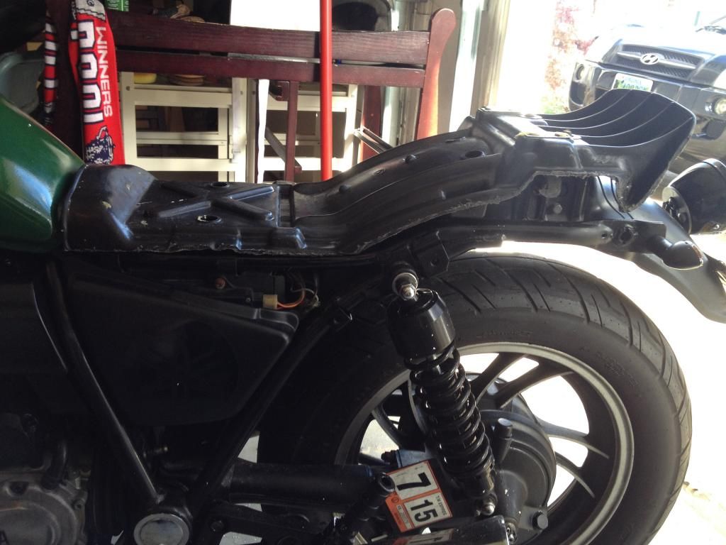

    My idea is to take a stock seat pan, cut it down and then re-foam / fiberglass it in such a way that it looks something like a single seat with a race hump.
    I got the seat pan thanks to a member here and got it cut down to the basic shape. It still needs a lot of sanding and finer shaping but you get the idea....
    Next I have to figure out how to create the upper shape I want. I'm thinking fiberglass but will fiberglass stick to the plastic?

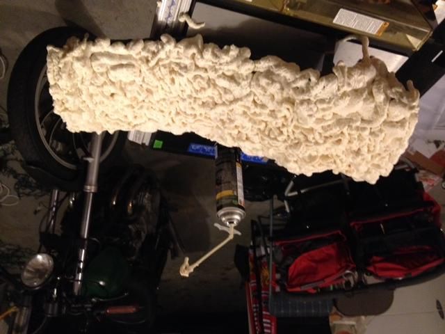

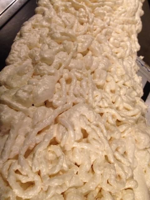

    Haha - fair enough - I was just wondering if anyone had any experience with fiberglass sticking on it's own to plastic. All the things I've seen on fiberglass seat making are focused on making it not stick - blue-tape, release agents etc etc - I have the other problem :).
    I have however decided to try making my shape out of spray insulation foam first so I'm going to give that a shot and see what happens.... this is the cutting each of MacGiverist Dohackery, I may die, I may find Narnia or if I'm very luck I might just make a damn ugly seat... :D

    over that i put the blue foam insulation, shaped it, then carpet pad for padding. hold it all together with 3M spray contact adhesive, #77 i think it was. i found the foam in a can is really messy and too soft to support anything, it melts other kinds of foam too :(

    Thanks for Pollock - I already started with the spray-can foam - so I'm going to see how this plays out - you maybe right - we will see. If it doesn't work it's just a case if pulling it off and starting over with that purple stuff you mentioned.
    I had this curing on the shelf in the garage and my wife comes running out shouting about a "huge f***ing nest" -- hahahaha..
