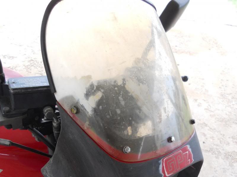

    bought this about a year ago for $300 running but not well. My old man bought me the same one in 87 when I was around 15. Doing a show quality restoration with some subtle mods. I have everything here new for it. I had the original red mixed in base coat. Got killer gray pearl to replace the silver stripe and bought a medium blue pearl to replace the blue stripe. Had all the vinyl done locally. Will clear over everything and sand/buff. Everything including brackets will be painted with automotive urethane paints out of my spray gun. Want it to last and look good for years and years. I removed unneeded crap off the rear frame area and built a smaller seat latch that's more hidden. I cut 2 inches off the top of the windscreen. Just too tall in my opinion. I sanded and buffed it to like new appearance. In some of the mock up pics I have real small turn signals but have sinced changed them out. I went with 97 GSXR ones. They have the basic shape as original but they are in between the stock and shorties on size. I used an H4 diamond cut headlight and modified an S-10 truck headlight bucket to fit in the GPz bucket so its still adjustable. I also removed the horn mounts from the frame. I made a new bracket and mounted one under the bottom triple tree. I have stainless allen socket caps for the side covers on the engine. I had spent a few weeks before strip down getting it running perfectly. It only has 8000 miles on it but it had a rough outdoor life. I bought a NOS instrument cluster surround so the wording for the stand, brights, etc. will be crisp. Also bought a new ignition switch so the lettering is crisp. I'm a perfectionist I guess. Wanting to finish it up in the next couple months and enter some bike shows.
