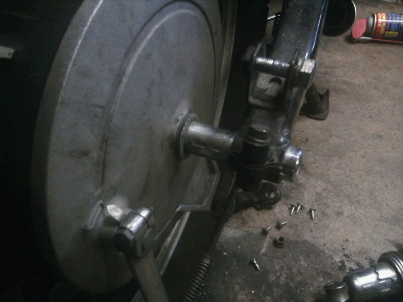

    does anyone have a picture of the right side of the rear wheel? The part where it attaches to the swing arm.
    it seams as if it's missing something there, as if the wheel is not centered.
    p.s.
    The rear tire is new. Looks like they replaced not too long ago, but did not do a good job reinstalling the wheel since the bolts were finger tight.
  9. Samson
    Samson Member
    96
    Lombard, IL
    Does this look right? Or is it missing something?
  10. iwingameover
    iwingameover Active Member
    2,145
    You're missing a shock.
    If the axle was that loose it could slide around a bit. I'd pull the wheel off, check the brakes, bearings, etc, then put it back together and torque properly and install cotter pins where applicable. Then see how it goes.
