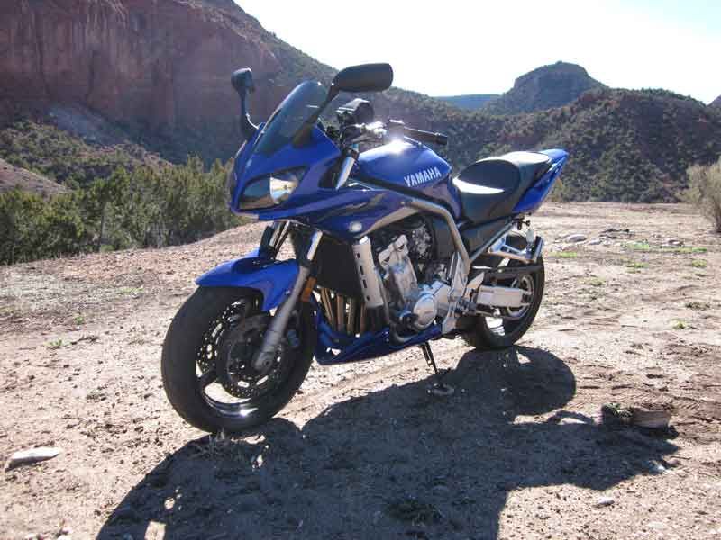

    I've been looking for a while and finally found something to spark my interest. Not an XJ but a Yamaha non the less. Project: 2001 FZ1 with blown motor and about 23,000 miles with extras including: heated grips, sliders, Pazzo brake/clutch levers, Sargent custom seat and LED turn signals. Got it for a decent price but will need a new engine so I have a bit of work to do. Closest thing Yamaha has to a naked bike in the states these days, looking forward to the challenge...

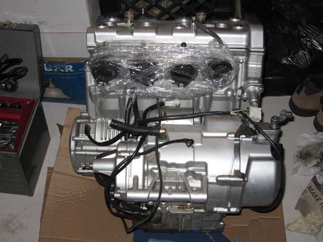

    I finally got a new digital camera so now I can begin to post my progress... Not much done the last few weeks but have been gathering supplies: new battery, mirrors, spark plugs, oil filter, 36mm impact socket to remove front sprocket to name a few things and have a shopping list of others I'll need to complete the job. One thing I plan to do on the new motor before it's installed is a valve check.
    Here is the new transplant:

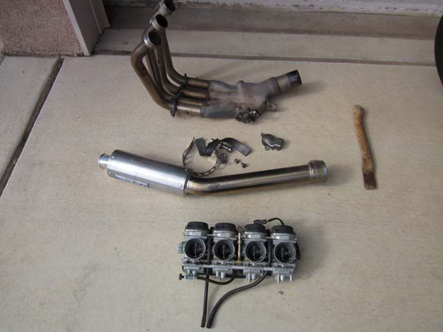

    I'll start by removing the carbs off the old motor first...

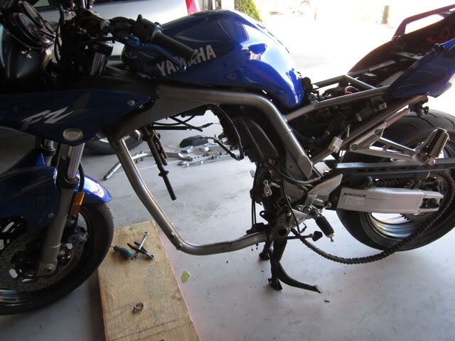

  31. ski84
    ski84 Member
    202
    New Mexico

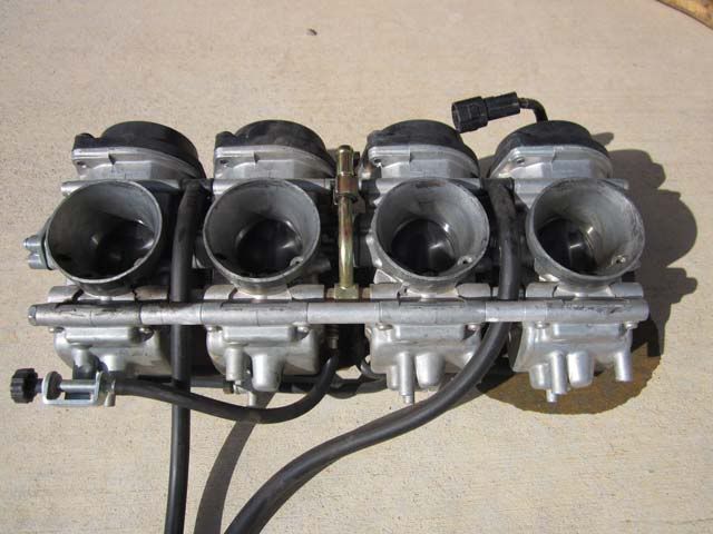

    Finally got a couple hours to play...
    Ready, set... carbs pulled

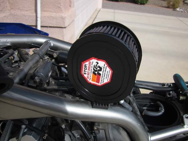

    Another surprise... I know some don't like K & N filters but I do and it just adds to the fact that a previous owner put some money into this thing.

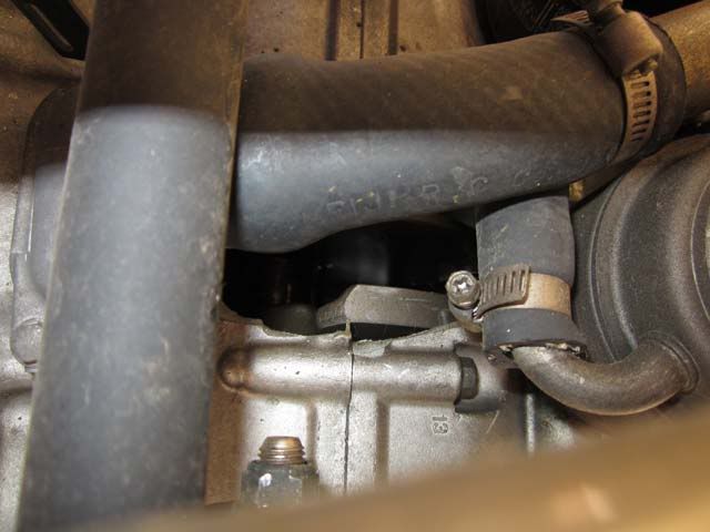

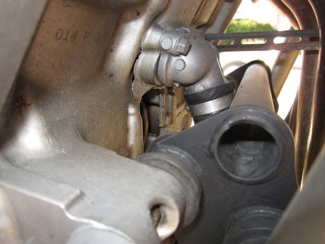

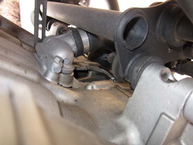

    Was there any skeptics about the hole in the engine?
    Parts...

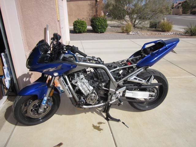

    Getting closer to pulling the motor...
  32. Orange-n-Black
    2,210
    Memphis Area
    Oh that's just a crankcase vent! :lol:

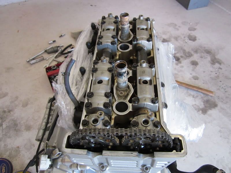

  33. ski84
    ski84 Member
    202
    New Mexico
    Got around to checking the valves on the donor engine and they were all within spec. However, the intakes were close to the low-side of good at .13-.15mm and all the exhaust valves were right in the middle at around .23mm. Decided to leave as is for now as none of them were to tight...
  34. bigfitz52
    That is one SERIOUS camchain. Looks almost automotive.
  35. ski84
    ski84 Member
    202
    New Mexico
    Actually bigfitz the picture makes it look more stout than it is.

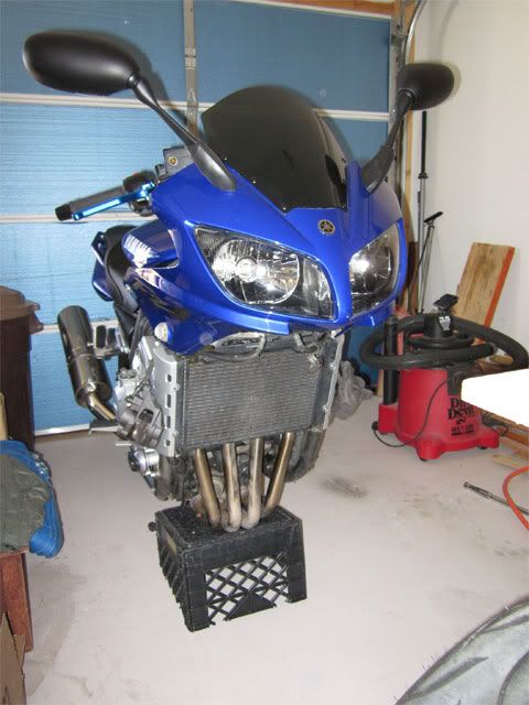

  36. ski84
    ski84 Member
    202
    New Mexico

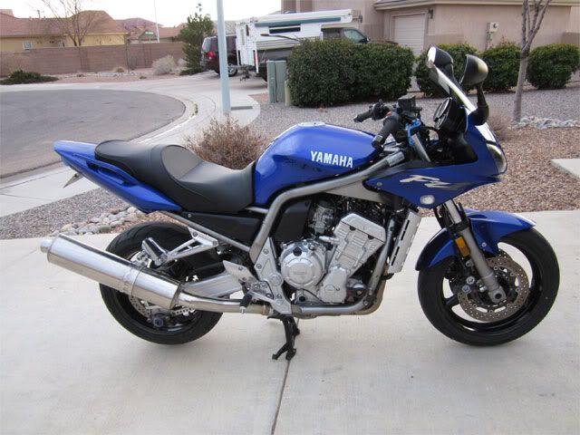

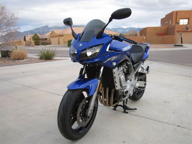

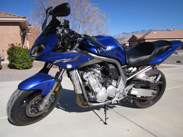

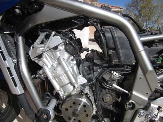

    I had some time off between Christmas & New Years so I got a chance to get a bit more work done.
    Old engine out...
    New engine in...

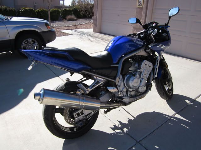

    With 20$ stock slip-on ...
    Still need to get the carbs cleaned/remounted, new fork seals, brake fluid flushed and new front brake pads installed. Getting closer...

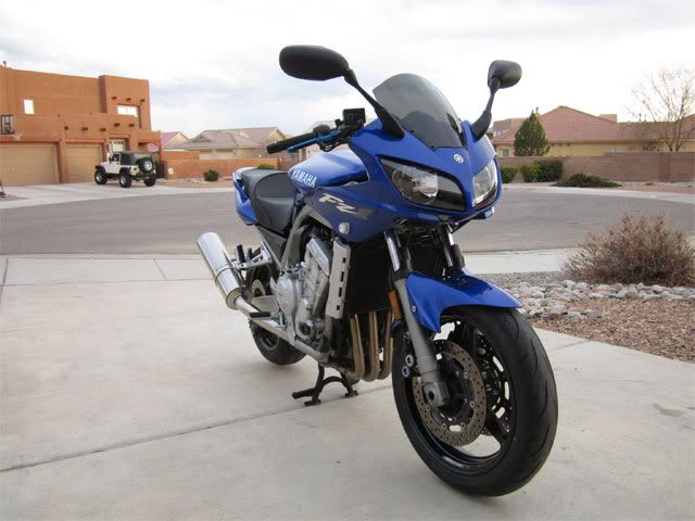

  43. ski84
    ski84 Member
    202
    New Mexico

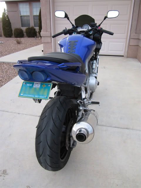

    It's Alive!
    Fired her up and took a short ride down the block and back... First impression: mucho torque, smooth, quite down low, great brakes, suspension feels good. Total cost so far, right at around $1850.
    Bills-of-material:
    original purchase price: $850
    donor motor: $675
    battery: $56
    new windshield: $12
    windshield screws: $7
    fuel filter: $15
    front brake pads: $17
    OEM fork seals/dust seals: $36
    new mirrors: $28
    bar end slider: $25
    fairing inner panel: $30
    3/8" X 4" nipples (fork spring pre-load spacer): $6
    fork bushings: $10
    crankcase gaskets (3X): $15
    127.5 main jets (4X) $14
    Radio shack washers for shimming needle: $2
    vacuum caps for plugging carb coolant: $2
    Maxim racing shock fluid: $12
    Rotella T oil change: $12
    SuperTech oil filter: $3
    Autolite spark plugs: $2
    stock muffler: $20
    misc supplies: $20-40
    Details of work performed...
    Engine swap: pretty straight forward. A little time consuming to disconnect and reconnect everything but overall not to bad.

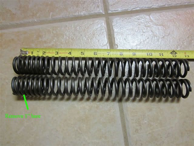

    Front end: Did a lot of research for the suspension. Ended up cutting 1 inch off the softer progressive side of the front springs (increases stiffness about 20%) for less dive under braking. Used super lite (3W) fork oil which tends to work better with stock valving for the fork cartridges. Had a bit of a time bending and shaping the spring after cutting to length. Had to get some Mapp gas to get the spring hot enough (propane didn't work). New fork/dust seals while in there.
    Front brakes: about 20% left on the pads so will wait to change when front tire needs to be swapped (2-3 thousand miles).

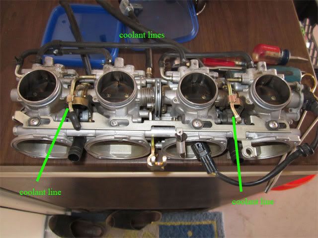

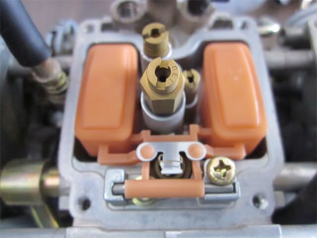

    Carbs: Did a bunch of research on the Mikuni's on FZ1OA.com as well. Pulled all the jets and carefully cleaned. The FZ1 tends to be lean down low and up into the mid-range. To correct this, I preset the pilot mixtures out about a half turn more than stock (richer). In addition, I shimmed the jet needle with a thin washer to richen the mid-range transition from the pilots. Over at FZ1OA.com, the standard was to add two shims but I compromised and did one. The FZ1 tends to run very rich on the top-end and given that I'm at about 5000 foot elevation, I decided to swap the main jets for something closer to where they should be for my elevation. I'm running a K&N air filter so I compromised on the main jets as well. The floats are set for too much fuel from the factory which also contributes to the rich condition at WOT so I adjusted them to a little lower fuel level. Replaced float valve o-rings which tend to get brittle with age and ethanol. With all this, it should be better than original but might need some fine tuning, we'll see...
    Carbs cont: Another thing that is very popular over at FZ1OA.com is to bypass the coolant lines to the carbs. Ya you heard correctly, Yamaha runs coolant through the carbs which can cause a type of vapor lock at high temps and elevation. I don't need no stinking vapor lock!
    Cables: all lubed.
    Whats left: flush the brake fluid (front & rear), swap the shock dog bones on the rear (to better match the modified springs up front), foot brake light switch isn't working. Finish cleaning and lubing the drive chain. Install accessory power port. Swap instrument lights for LED's. And last but not least, drive...
    Overall, not too bad for $1850! Thanks to XJbikes for the inspiration that began a couple years ago with my XJ750... to be continued!

    There were a couple reasons: 1) to save my ears and 2) cost was $20 for a used excellent condition one. My thinking was to put as little into it as necessary until I was sure what I had overall. Also, I figure if I have to sell the thing, I would like to maximize my profit. I have a suspicion though that I may hang on to it for a while.

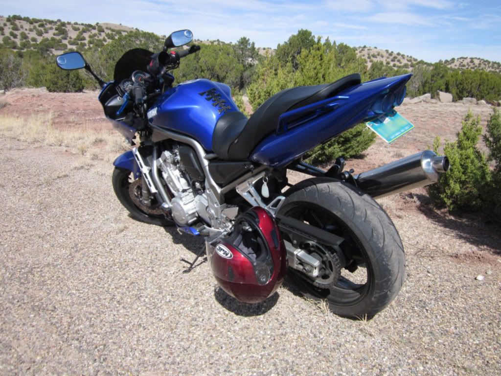

  47. ski84
    ski84 Member
    202
    New Mexico
    Managed to put down some decent miles (360) on the new machine this weekend. Everything is pretty much done on it with the exception of wanting a sport touring windshield and installing an accessory power port for my GPS. One of the best features is the fuel mileage; I got 45.7 MPG yesterday on a spirited drive through the Manzano Mtns. It looks like I can get somewhere around 220-250 miles on a tank full of gas. That gives me more options on the road knowing that I don't have to fill up all the time. On my Maxim, about the best I could get was around 175 miles for the type of driving I do. What the FZ1 does better: handling, increased fuel mileage, reduced riding fatigue with better seat and suspension, superior brakes, better lights, way more power and a higher grin factor. I know it looks like a sport bike but surprisingly the FZ1 has a sit up posture with just a slight amount of forward body lean towards the handlebar (unlike a full on sport bike). What this does is it gives me less lower back fatigue from my spine being slightly off vertical and my kidneys take less of a beating too. My Maxim is set up to handle more luggage and has a few options for feet placement on long drives plus a shaft drive which is pretty maintenance free. I still can't believe how little this new machine cost me with the work I did myself and knowing that these machines can do 100-200 thousand miles before overhaul. The donor engine seems to be very strong. My original plan was to fix it up and make some coin but now it'll be hard for me to let this one go. If I decide to get rid of one, sorry to say it might be the old Maxim, but I ain't in no rush. I'm taking quite a liking to the FZ1!
