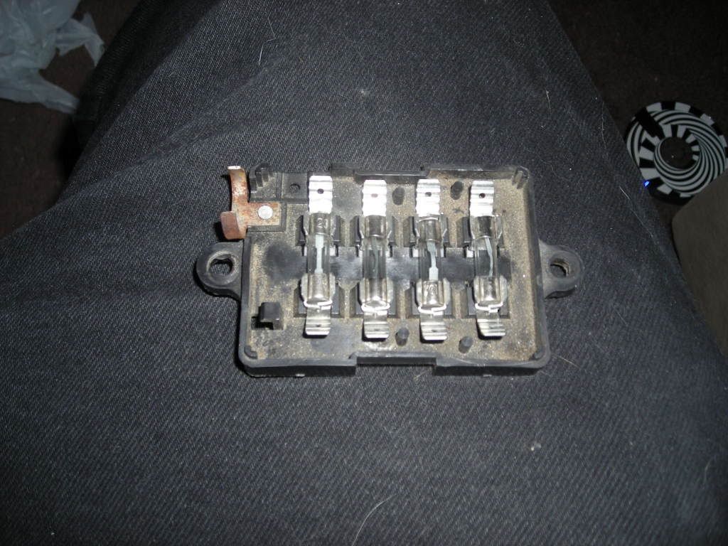

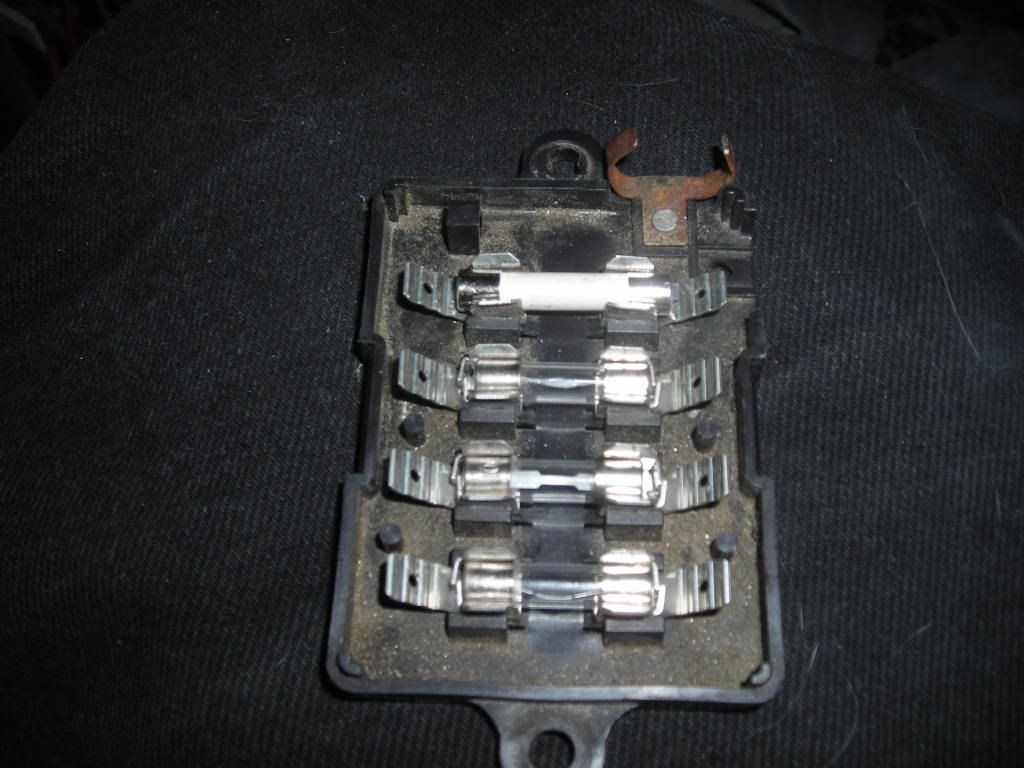

    OK guys, here is the photo of the new tabs with original fuses.
    So all is well there.
    But the notch keeps the clips from going out further, so I had to do this with the new ceramic fuses I got...
    Is that enough contact to be OK?
    Otherwise I either have to stick with the glass fuses, OR dremel the notches out which will in turn mean gluing the clips in place.
    While on the subject of fuse boxes, if I trimmed the wires RIGHT at the original tabs, I should have plenty of wire to solder with even if trimming some crap wire off the tips, right?

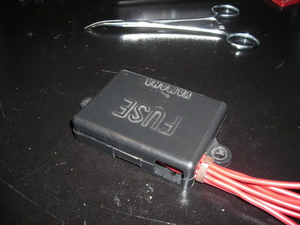

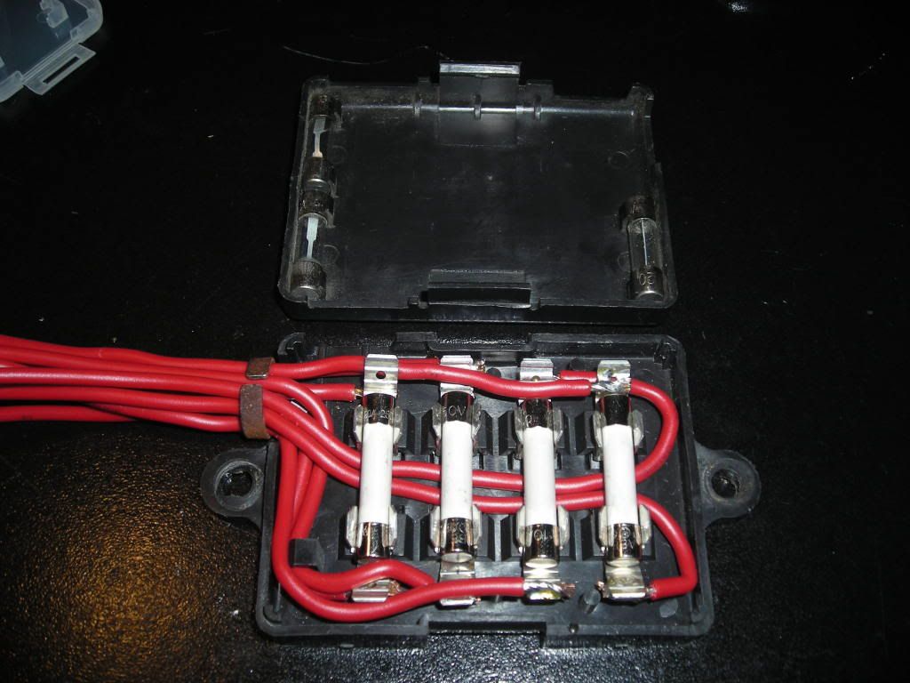

    Well guys, here 'tis!
    I have not soldered yet, doing that when I get home tonight (in about an hour) Will get a pic of the solder work done too, after.
    Wow... doesn't that look JUST like the original box...?
    But wait, it's the same, but different, but, THE SAME!
    I'm lovin it!
    And yes, that is 14 gauge wire. Bit too big, but I think I like it.
    Guess my guess of how big the wire was on the bike was a bit off. But it's better than being smaller than what I had on the bike!

    Thanks stereo- Should be interesting to solder. I think once I figure out how the wires will mount to each tab, I'll draw a diagram of it, then take the actual tabs OUT so I can get them soldered easier.
    What do you guys think: Solder to the BACK of the tab straight across, or trim some of the heavy wire off and push it through the hole, bent it, then solder?
    If I do that way, I should probably bent it over the front and THROUGH, and pop out the back, right? Look cleaner?
    I think I should just solder to the backs, but let me know what you guys think.

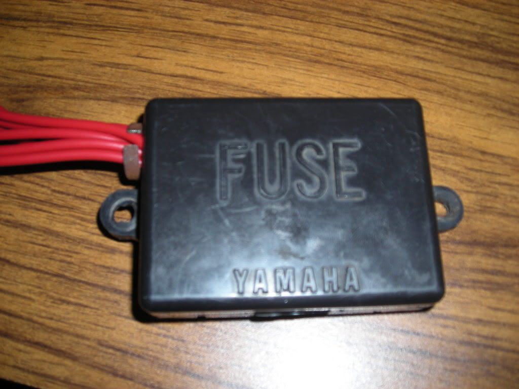

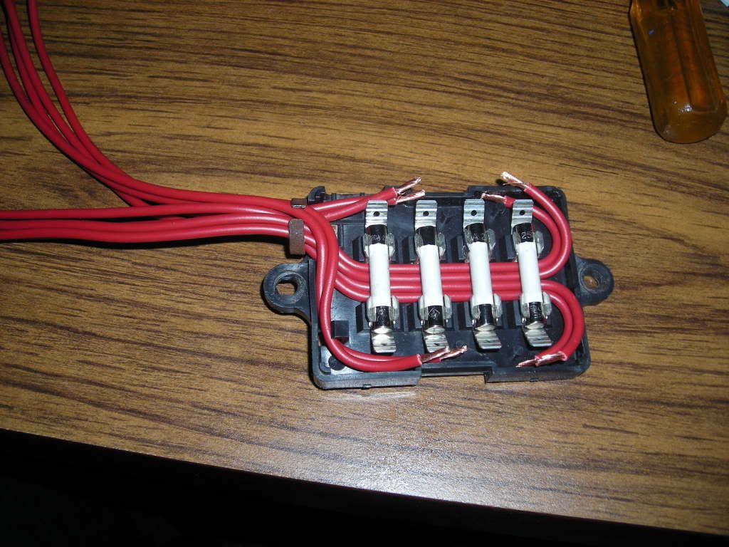

    Yay! All done. Now just need to wire it into the bike.
    Overall, I am very happy with it.
    But once you take the cover off, my OCD kicks in.
    Due to the soldering technique + the heavy gauge wire...
    the solder traveled up inside the wire, causing it to be even harder to bend than it already was. You can see this in the picture, furthest from the wire output area, on the right. Big kink, barely got that tab in there.
    Also, soldering the wires on OUTSIDE the box, and then attempting to push them in, with all that other junk in there... not easy!
    But I got it done. And hey, it ain't going anywhere.
    The original fuses are still in the backup spots in the cover, and it still fits fine!
    I wish I could have got the wires rerouted better, but they don't want to bend easy as it was, and if I bent too hard - the clip popped out. Grr.
    Anyway, I am settling with it. It makes me happy that everything is REAL tight, and solder is rock solid. The wire strap is working great, and without the cover off, it looks 100% stock!
    I like it. Really I do. But I still wish it was better. Meh.
    Without further ado, the photos!
    The case, as it will lie in the bike!
    And what you've all been waiting for...
    My botched up wiring job!
