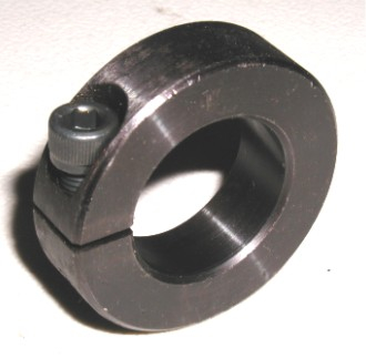

    If you want to revert to having air-adjustable forks you could do so by getting a pair of air collars and new o-rings, along with suitably sized locking shaft collars (see photo below) to hold the air collar in place. You will also have to clean out any epoxy from the air passage.
