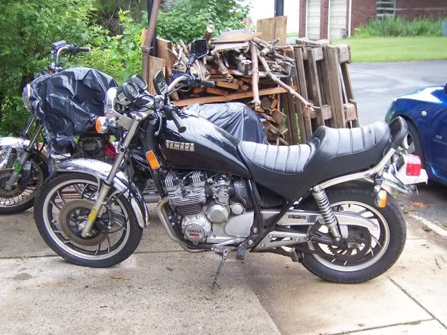

    Hey everyone. I'm not sure if this is the place for this but I wanted to introduce myself. My name is Jen and I'm new to the motorcycle world and signed up for some advice and guidance from the guru's. I picked up an 82 Yamaha 550 Maxim last night. I know it needs a few things and I have no problem working on it for the price I got it for. I've already searched the site and found so much info that I needed. I'm so glad I found this place.
    Thanks for letting me join and I hope at some point I can return the advice I'll be getting.
    Here is a pic...she was $400.00 with just over 10k on it.
    Story I got from owner...Bought it from original owner, had carbs rebuilt. Brought it home changed fluids and was going to get it registered and inspected next day. Left a full tank of gas in it overnight came out to empty tank and gas everywhere. He never got around to fixing it and it has sat around ever since. Told me float is stuck so I have a guy lined up to look at it.
    Issues:
    Tank rusty inside
    Tires dry rotted
    Turn signal stems broken
    Goods:
    Runs
    Little to no rust
    No rips in seat

    You've definately come to the right place. This forum has saved by butt a time or two and you will eventually start repaying the debt. Tank rust can be resolved, just search the forum and you will see several topics on it (electro de-rusting, chemical, liners, etc.). This could be your problem with gas holes, but that should show up in the paint of the tank. Although floats could do it also, if the carbs were just done, could be upside down (also on the forum in several places).

    [justify]Hey PAk,
    I'm another nub joining the group. I just wanted to say your bike looks beautiful. I have a 81 xj550 Maxim. It looks like a clone of yours. I've already done some carb work on mine and rebuilt them. It's not too bad. Good luck its a nice bike.[/justify]

    Anyone know why I can't see a pic of the bike? Nor a gallery link?

    PAK, if the floats were/are leaking, then I would NOT be "running" it AT ALL, since there is a very good chance that the crankcase has some of that overflowed gas in it, and running it in such a condition is a grat and quick way to destroy an engine! The over-flow problem (if that is the cause) needs to be solved and the oil needs to be changed (best to do it twice) before the bike is operated!!!

    Interesting, what should I be looking for then if it's not the floats? I'm just going off of what the guy told me. It ran for a minute when I went to look at it with him spraying something into the carb I believe it was. It has not be run since.

    Sorry I just read it again and what your saying is to get the floats checked first then run it. Sorry it's early in the morning.

    For the fuel to have emptied a full tank overnight the petcock must be open.
    As well as the valves not seating.
    So you have a 2 fold problem.
