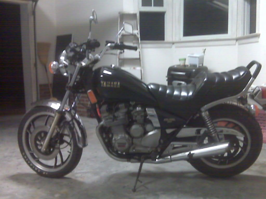

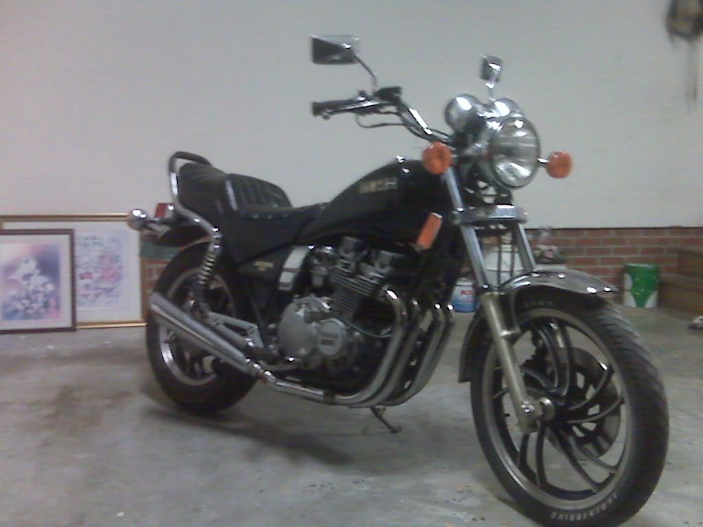

    Here she is.......
  13. clipperskipper
    clipperskipper Member
    212
    Cape Cod, MA
    Good shape I can't get over the pipes!
