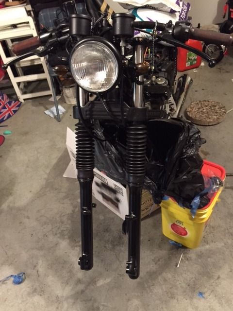

  28. Ribo
    Ribo Prefectionist
    996
    268
    rocs82650, NEEDtoRIDE and BaldWonder like this.
  29. chacal
    9,257
    2,035
    Looks good!
  30. Ribo
    Ribo Prefectionist
    996
    268
    Thanks Len, it's coming together, been a long road. I think I bought those gaiters from you what, 6 months ago :)
