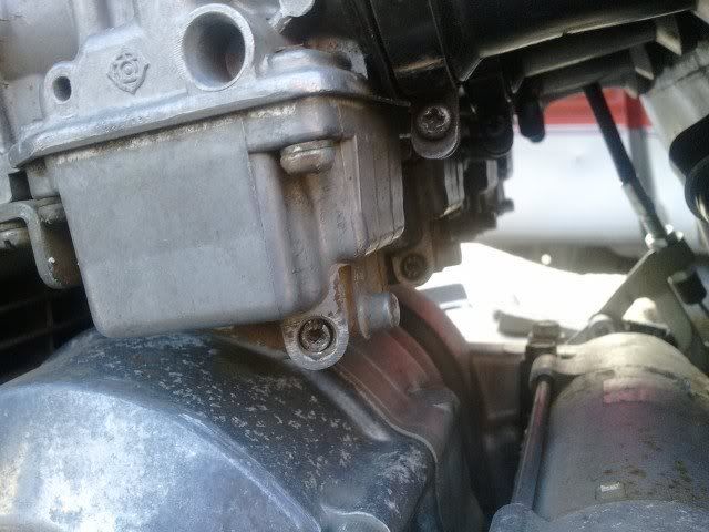

  3. bigfitz52
    Mikuni drain screws; the drain ports are the open holes facing rearward, just to the right of the drain screws in the pic.
    These are the left pair of carbs; there are drain screws on each carb. You can also clearly see the main idle knob in this pic, if you're interested.
    When I drain mine in the spring, I simply wad a whole bunch of paper shop towels in behind the carbs and open the screws.
