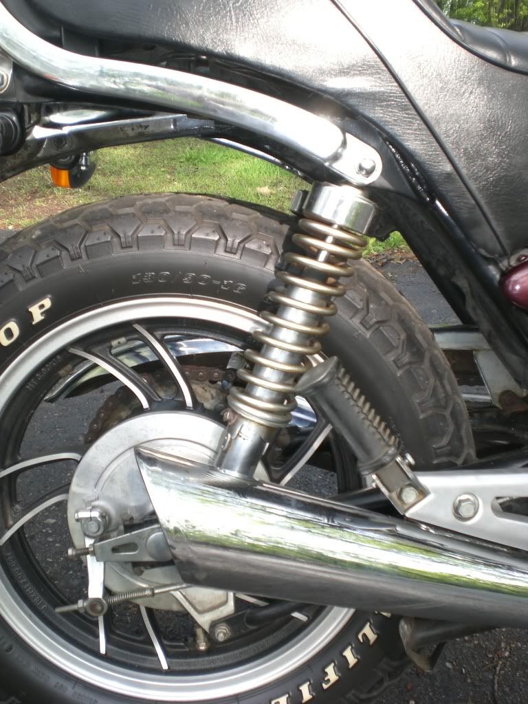

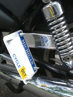

    After a long time searching for some shorter springs I FINALLY found a new set off a Sportster (new) for $75.00. Not only did they work perfectly (after a bit of tinkering with the rubbers) but the beefy chrome looks quite nice.
    I know I got a scream of a deal but they would be well worth it if you have to pay more....
    Before:
    After:

    yeah they look alot better, but Keep them waxed. NO JOKE! i've had a few sportsters and if u dont keep them waxed they will rust and look like shit quickly!

    Does it matter what year sportster shock to use?
