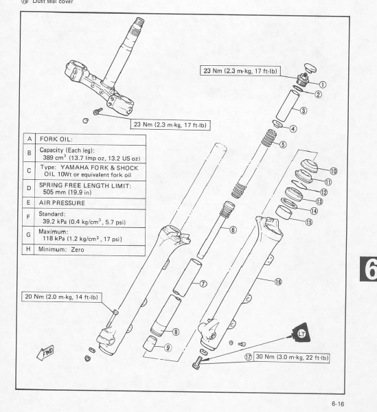

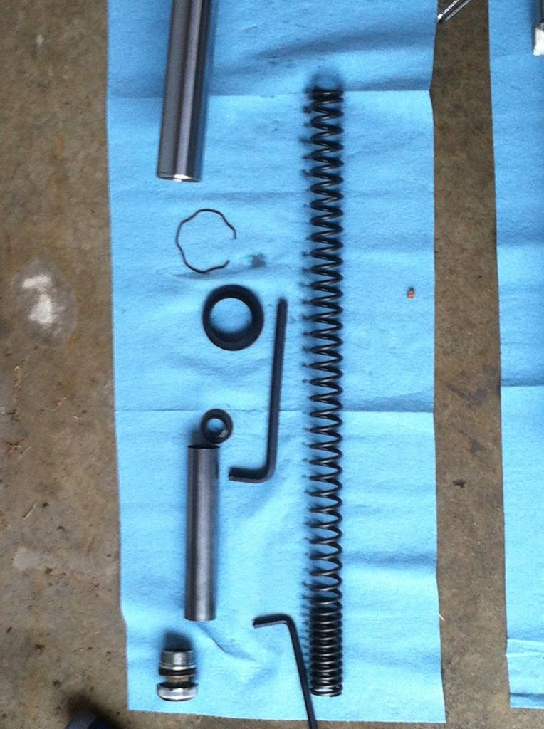

    Alright Guys I am at a stuck point. I have the springs out and have the bottom hex bolts loosened to where I can turn them without the mounted. I have the springs out as well as the spacer and spring set. The dust cover and circlip are also removed. I have drained the oil. And the air release. I cant get the bottom bolt out it just spins it seems? Every video I have watched says that it should come out and the fork should split.
    I've been using the video posted earlier.
    this:
    http://www.thereeftank.com/forums/f21/h ... 10599.html
    and this from my service manual/
    am I missing something stupid?

    Okay so apparently there is some type of a bolt down in the forks that requires "from another thread I read" A t handle tool. Which is no longer in production and needs to be fabricated if just turning the bottom hex key doesnt do it...
    So i would like to try the method where you use the front axle as I don't have anyone who can weld... I got it from this web page :
    http://www.bronyaur.co.uk/xj9003.htm
    So do I just lock two nuts on it and drop it down the fork attached to an extension or two? It looks like I'll need almost 10 inches of extra spacers with the axle to get it down there... then do I throw the side that has the two nuts or the solid axle bolt down first? Do I need to go buy a long extension?
  29. ryancdossey
    ryancdossey Member
    825
    Indianapolis, IN
    Also I got the dust cover and the circlip out but nothing further. Will this method work with just the parts pictured above removed? Or is there something else that I need to do?
