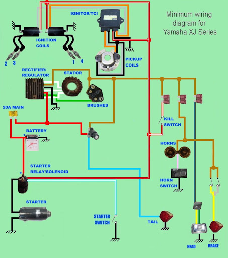

    Hi all, been a while...life gets busy. Anyways I have grown tired of fighting with the constant corrosion and broken wires and connectors on my 28 year old 750. I am going to do the minimum wiring thing. I am not afraid to dive in and just rip all of the wiring out and start from scratch. I have the tools, the time, and you guys. :D I am going to use this schematic
    http://www.currentobservations.us/image ... Series.jpg
    My problem is that I am a very visual oriented person and I cannot completely visualize the finished product before I get started. So I did this to the schematic (hope whomever originally created this is not offended)
    Could someone please let me know what the errors are in this...wiring colors, names, and part pics. Also I am not sure about the unfinished part around the lighting. Why are there different color wires connecting to each other?
    Thanks
    David

    i love the pics attached to each wiring lead. makes it "fisher-price" easy to read, great job.
    ps, have no idea if it's right, just really like your concept.

    I agree that the concept is great.
    Critique:
    The correct wiring positions of the TCI are paramount to a successful harness. A diagram (not unlike the Haynes schematic) would be a very important detail to include.
    I would remove the second line from your starter supply line (from the solenoid) and note the polarity of the solenoid.
    To answer your question about different color wires connecting, this occurs here and there, the neutral switch is an example. The switch wiring harness (bundled with the pick-up coils) is Blue. The main harness wire connection is Ligh Blue (Sb). It is my understanding that Yamaha is keen on using off the shelf designs (i.e. parts, look at the history of the Radian/Phaser) to build their bikes. This is why the solenoid from the 80 Max will work on the 83 Seca. The the various subassemblies are made, initially, for one particular model and will match that systems wiring colors. Anything else down stream will either have to match the existing components or you will see a color difference. It makes sense to use an existing, solid design and buy large quantities of that design to get the most economy of scale out of it.
    When I have time (this century perhaps) I'd love to help you with your quest. Please PM me if you would like some collaborative help.

    Thanks for the comments...
    Robert I see one of the flaws after you had me look at the TCI. I need to point the lines to the appropriate plug positions.
    I also need to change some of the wire colors to more closely match Yamaha's
    Back to work
    David

    Making a little progress... have a question though. I know what a diode does but I don't know what role the diodes on my XJ play. I think they are dealing with the safety stuff but aren't they important for the charging system too? I don't find them on any minimum wiring plans around here so it must be okay to do away with them, am I right?
    I am also using the haynes schematic as well as the 85 harness for reference As painful as it is I think I am starting to understand some of it.
    Anyways, I will post the latest progress for critique later
    Thanks,
    David

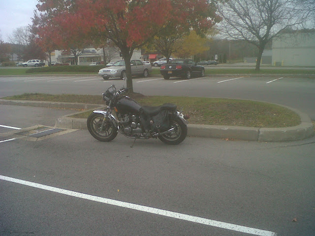

    My ride, by the way, when I was waiting for some help getting her home (s[color=red :oops: [/color] cell phone pic)

    Rochester, NY
    Some of them. I am going to use the gauges off of the 85 xj700 I dismantled. they have the neutral, high beam, turn signal indicators, and oil light. I wanted to use the whole front end but the steering necks are too different and beyond my abilities to make work.
    I just haven't gotten the gauges in the diagram yet. I want to be sure that what I have will work before I add all of the other "extras" to it. I also have a smartblink module I am going to work in
    http://www.harrisonspecialties.com/mm5/ ... de=MODULES
    and a brake light modulator also.
    I am hoping for a little more critique on the viability of what I have worked out so far

    Think I'm going to stick to corel. I have forgotten too much to make it worthwhile for me to use AutoCad. Can't even remember how to set up a drawing lol. Too many side effects from a past life I guess.
    The setup I am making is for what I plan on doing to my bike. It will not be the absolute minimum for it just to run. I do want signals and indicators and probably a 12v source for gps or cell phone charger.
    I still haven't gotten a yea or nay to the workability of the updated diagram I have made. If someone could let me know I can continue on.
    Thanks
