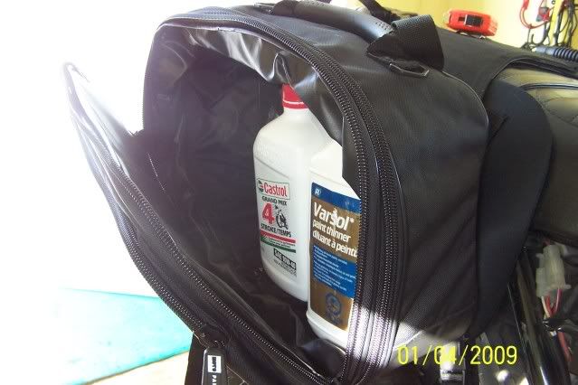

    Attached photo shows a liter/quart bottle of oil and varsol sitting inside. Two more would easily fit standing up. Inside dimensions are about 15" X 10" X 5". These bags expand width wise to about 8".

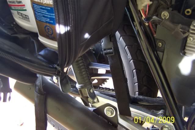

    This is the front strap looped around the passenger peg bracket.

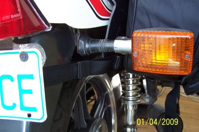

    I crossed the rear straps under the licence plate to the opposite bag.

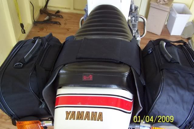

    This shows the main strap over the seat.
    You could still carry a passenger but they would be sitting on the main strap and the back of their legs would be pushing on the saddlebags. There are no problems with turn signals being in the way. The shocks keep the bags away from the tire and wheel. It's going to take a minute or two to hook and unhook the straps. If you look on E-bay, these bags, and the larger model, are always for sale. I paid $82.00 US.
