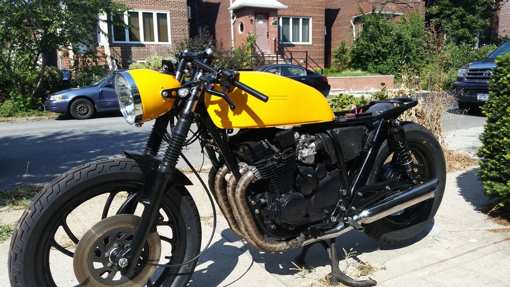

    Moved speedo into my headlamp which sits lower. The original speedo cable is now too long.
    See here:
  7. XJ550H
    3,863
    nice setup did you fab the head light bucket or purchase it. Nice and clean look
  8. saftie
    1,121
    284
    New York, NY
    Thanks. The bucket is of a Puch. I bought it years ago while working on a different project but ended up never using it.
