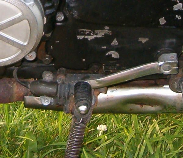

    I just tore apart the side stand to clean it, re-grease it and find out why the safety switch doesn't work. I noticed that there is nothing to activate the plunger on the safety switch. Is there suppose to be a tab or something attached to side stand?

    I wish I could have found a better pictuer, but here is the side stand switch on my 1985 Maxim-X:
  3. bigfitz52
    420
    This is a 550, yours is probably quite similar:

    Ah, Ha! I seem to be missing the plate that activates the plunger. On my bike there is only one spring that goes from the hook on the side stand to the pin protruding from the frame.

    According to the fiche for your bike, there is only one spring but there is also a little plate similar to what's pictured. The spring is supposed to hook to it, and the link hooks on the peg on the frame.
    Link, Side Stand; Original PN 2KT-27315-00-00 superseded by 3VD-27315-00-00. Still available from Yamaha if Len doesn't have them.
    Fiche: http://www.yamahapartshouse.com/oempart ... d-footrest
    Sorry but the switch doesn't warn if the stand is UP. It causes the motor to shut down if you drop it in gear with the stand down. It's stopped me from riding off with it down more than once.
