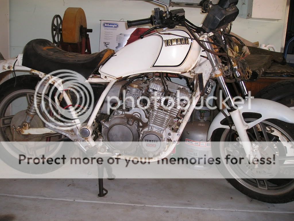

    I was offered an unknown condition 1983 XJ750P from a friend for $250, i paid him off and started stripping it for a rebuild, was told motor was working when ridden to my friends place and died from a holed fuel tank.
    How's the size of the pics, do they need to be smaller, anyone?

    Rockerto, someone put a "turbo" front end, brakes and rims on that Police Special. Is that the Police saddle?

    I did not know that, i like the curved spoke rims better. The seat is not a hacked job as the tangs in the metal are there at the back of the saddle, Unfortunately the saddle base is nearly rusted out and i will have to make a custom low profile seat now.
    -So got her back home, had been sitting in a shed for 7 years.
    I started stripping it back to powder coat the frame, tank had major holes in it so i got a better one for $50 in later pics, the tires and front forks were shot and everything needed cleaning.
    It's an ex-police bike from Western Australia, the plate says 1983, but my Yamaha dealer codes the frame as 1985

    I especially liked the way the sidecar frame was attached in the front using XJ900 rear shocks.
    Unique gauge cluster, too..........
    In one of your earliest photographs (2nd from top) the engine side covers have the unique finish combination that is normally seen on 900 engines....black outer rims with polished central sections......that, combined with the 900 cylinder size that you mentioned........have you double checked to make sure that is not in fact a 900 engine in there?
    The engine cc's are cast into the cylinder jugs, front center top, just underneath where the jugs mate to the bottom of the cylinder head (under the cam chain tunnel).
    You can also check to make sure that is the original engine out of that bike, the "shorty" VIN that is stamped into the engine case, on the flat pad behind the clutch cover, matches the frame serial number (assuming that Police engines followed the same ID protocol as all other bikes).

    I count 18 teeth on the "middle gear", 900's and 750's had different gearing. I'll look for it.
    That's a 650 turbo rear rim. There was an odd 750 in a "turbo 650" chassis for the Japanese home market. Slight chance of that as the source of your "turbo" parts.
    I've heard BOTH, that the brake shoes are the same, and that they're different. Rumors. . .
    I have a '82 turbo, a 900, and a 750. You'll have one unique bike when you're done.
