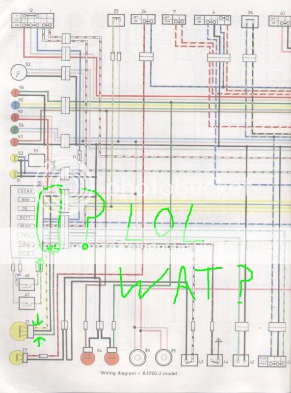

  8. schooter
    so i looked over the diagram, i see the two wires going to the light, but once the go into that bank, I do not see the same ones coming out... as seen here:

    ok- i pretty much figured out what this relay does... a wire fro mthe switch runs to the relay, the wire feeding that wiregoes to the fuses, now, what the relay does, is it has a ground wire, then another wire running to a diode block, which has a wire running to the starter switch... so all this must do is turn the lights off when the starter button is engaged... i can ride it for now eliminating that, but ill try and get a relay cheap at some point....
