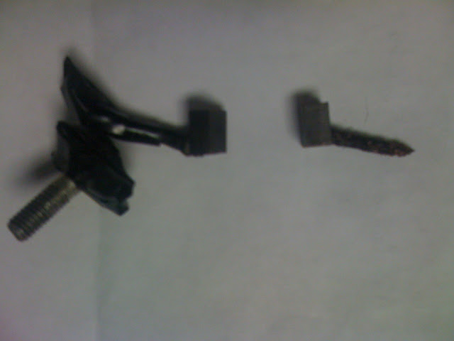

    Oh man, I'm stoked. I'm gonna do this to my starter today when I get home from work.
    Here's what my brushes currently look like.

    Where can I buy new starter motor brushes at?
  14. chacal
    9,181
    1,981
    We have them in stock, drop us an e-mail or PM and tell us what bike you're working on.....
  15. nelkindotnet
    nelkindotnet Member
    33
    Just sent ya a PM chacal. Thanks!
