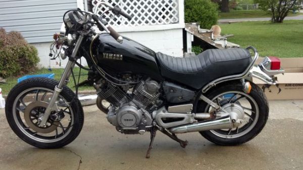

    Here is a pic of the poor beast

    To bob or not to bob. I would bob it. V's look great bobbed.
    I believe the starter/starter clutch is the same design as the XJ and are known to give problems as well as tranny problems. Hopefully someone with Virago knowledge will chime in.

    Forgot to mention, the bike in the picture you posted appears to be an '83, not an '82. The 82 had a square head light and a Cycom with the adjustable handlebars. Also the exhaust mufflers had a taper cut at the end rather than a square cut.

    The bike also looks identical to my 1981 XV750.

    Looks like they used the "pivoting" caliper brake like the 650 Maxim too.

    Yes, the rims, brakes, fork assembly, hand controls, and rear punkin are all interchangeable with the 650 maxim. The 920 virago had dual discs on the front and that would swap with the 750 maxim.
    The one shown has the wrong turn signal lens showing, and some are missing...
