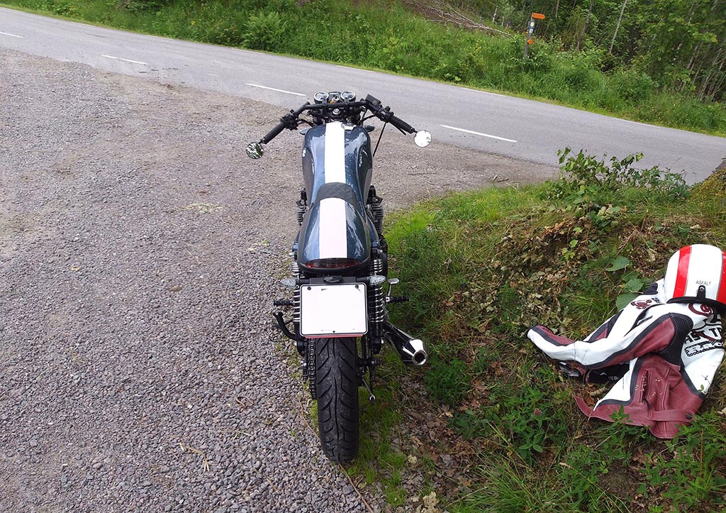

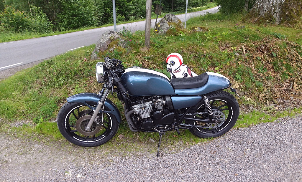

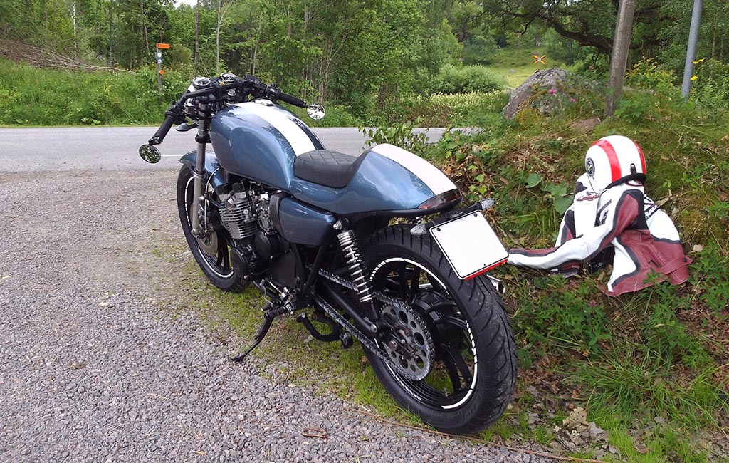

    Okey, So now when I start to get the bike running as it should (close but not their yet, waiting for new pilot jets) I thought I'd post some more pictures and a cellphone video of it running.
    Video here :
    https://www.youtube.com/watch?v=fUsMJbEpbDE

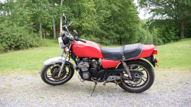

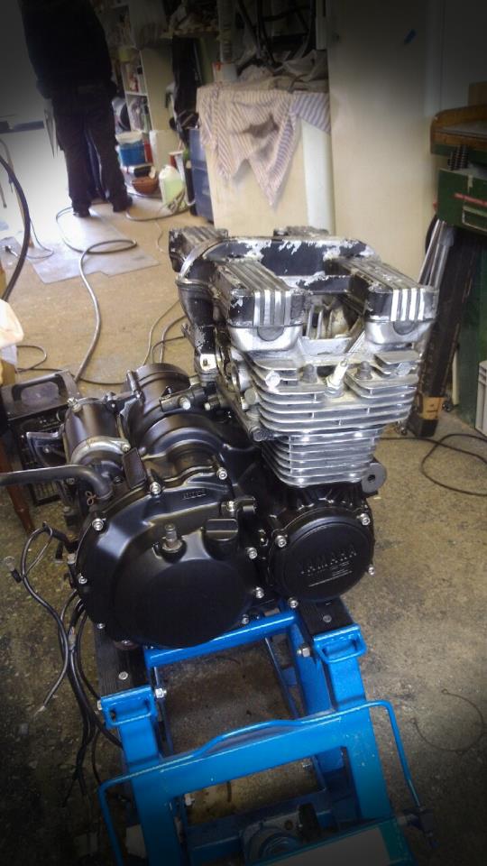

    When I bought it :

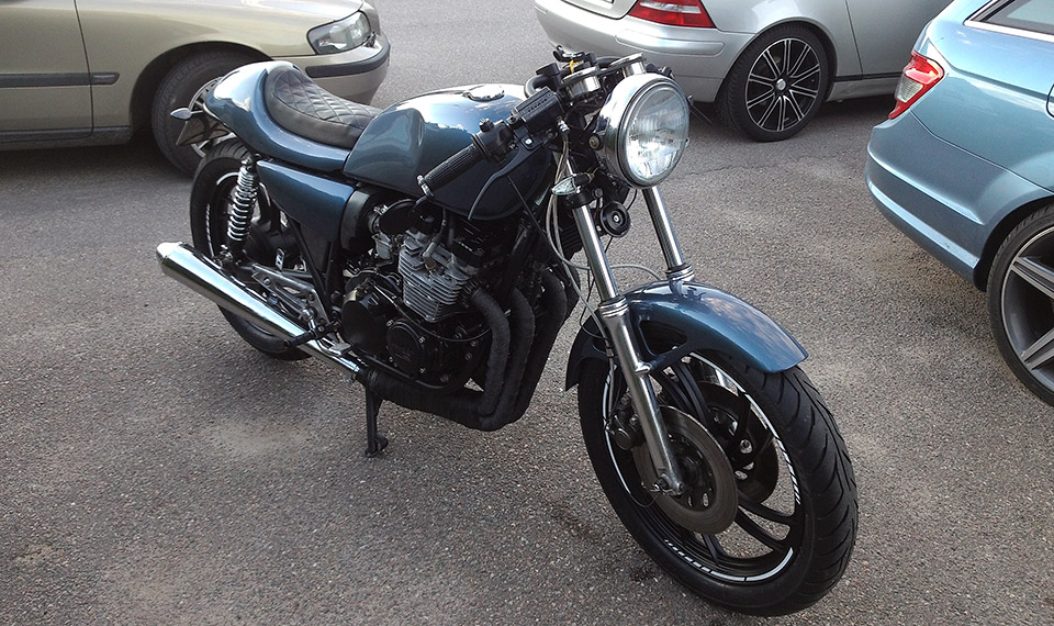

    And now :
    Some pics from the build :
    Thank you all for the answers to my problems and thoughts!
    And Thanks to Xj4ever that have supplied great parts and great service!
    Ketchup, Franz and Jetfixer like this.

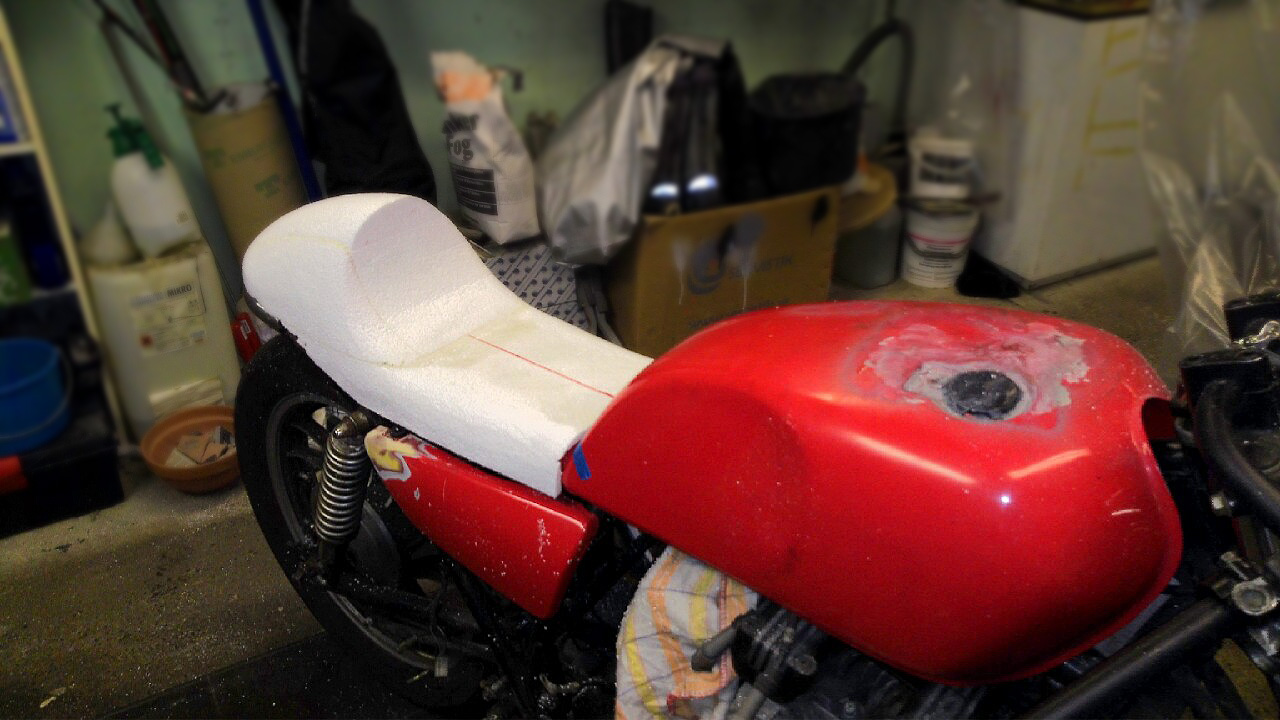

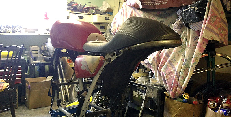

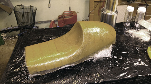

    I started out with a basic sketch on paper what line I wanted the seat to have,
    I then glued some High density foam blocks together to cover the area of the sketch and making grooves in the underside of the foam for the frame tubes.
    I then transfered the lines of the sketch to the foam and started cutting it down to a manageable size.
    And after that I just kept shaping it with a small saw and a file (rasp).

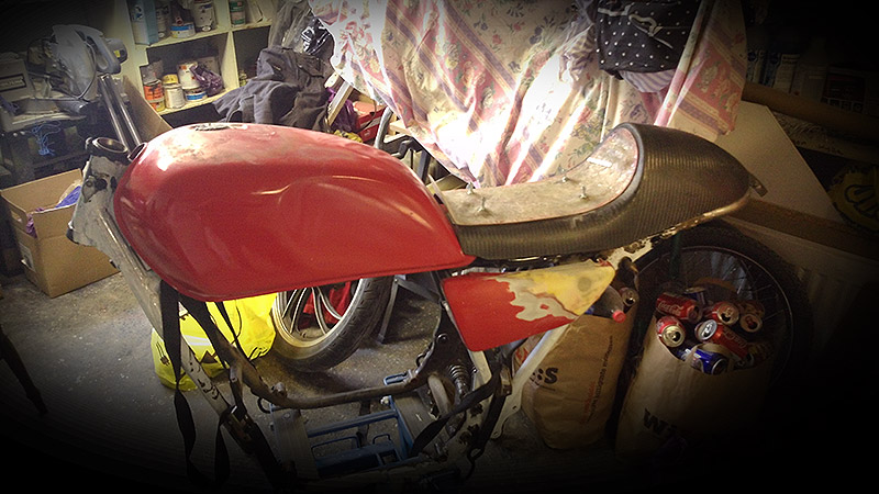

    I then taped up the finished shape with "mold-tape", a tape with a wax-like-surface, then started to covering it with layers of "high-temp"-polyester and fiberglass to make a mold of the foam seat.
    (the high-temp polyester, isn't really high-temp but it's a polyester that survives a low curing heat in the autoclave)
    When the foam was carved out from the mold a grueling period of sanding and overuse of filler started.
    Just to remove the marks after the tape and small air bubbles I managed to get in the mold.

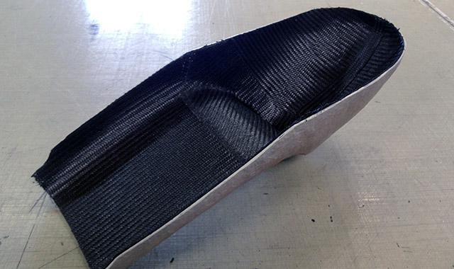

    Here I could have just applied an epoxy-primer and then cast a fiberglass seat in the mold.
    But I have a friend that works with building big catamarans in Carbon Fiber, And he said that I HAD TO make it in carbon fiber, just because I could.
    So anyway, the Epoxy-primer was applied and I then (under guidance of my friend I must add!)
    applied release agent in the mold and started adding pre-preg carbon fiber layers to aprox. 2-3mm thickness.
    After that we bagged it and added vacuum and put it in their smallest autoclave for curing
    (on low temp it took 8 hours under heavy pressure).
    And then done! Out came a nice carbon seat cowl.
    As stated the last part making the seat cowl is overkill, but the principal of the mold is the same.
    Hope this covers what you wanted to know! :)

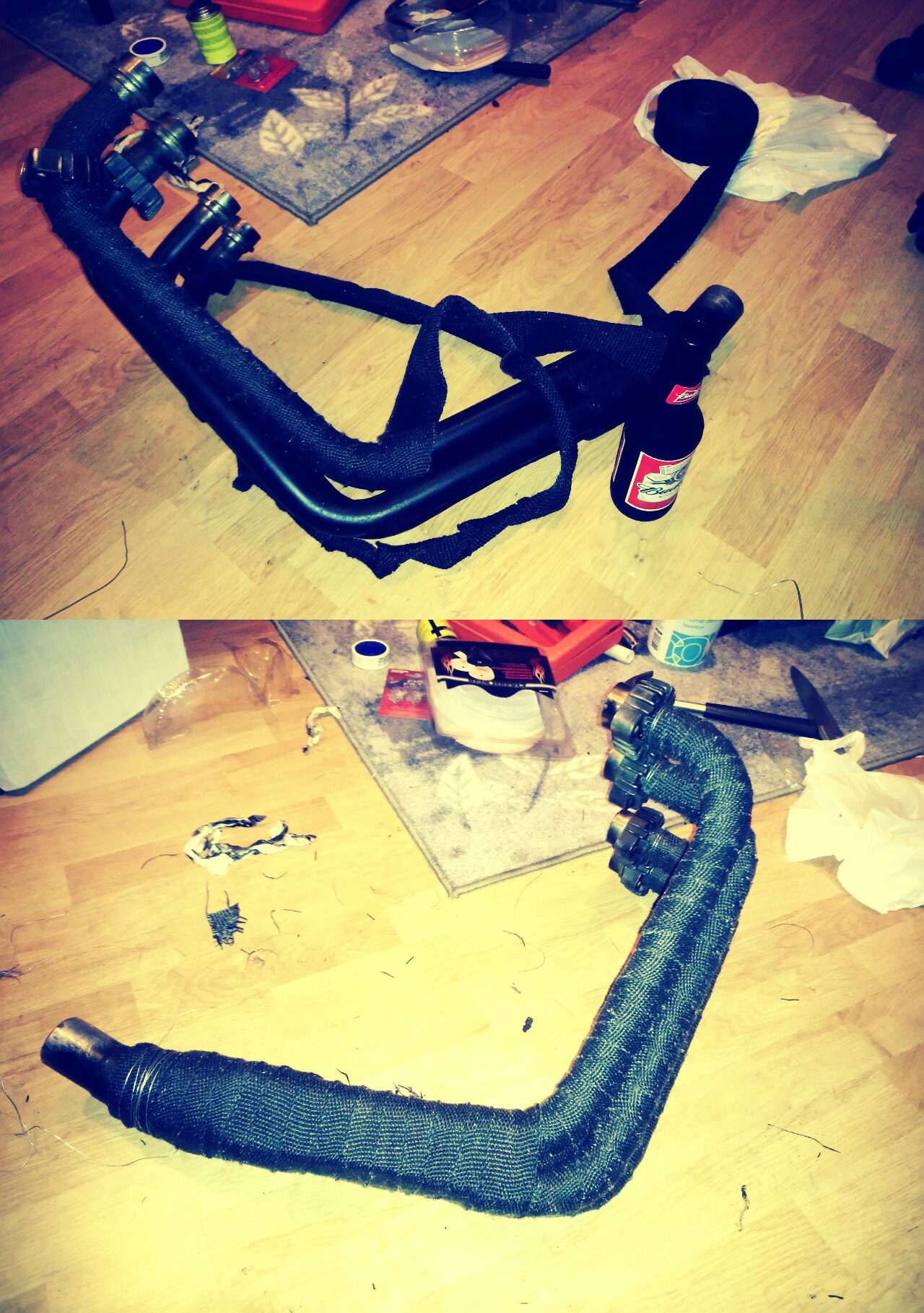

    4-1 Exhaust repaired and modified for the new muffler.
    4-1 Exhaust painted with "hot paint" and then wrapped with Exhaust wrapping.

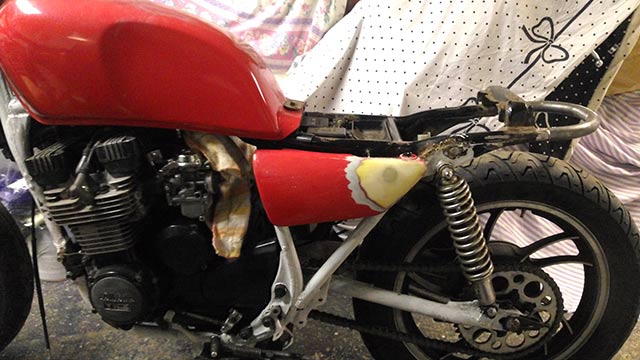

    Frame :
    Stripped off all old brackets for the original seat.
    Cut of the rear section.
    Welded on new rear hoop.
    Welded on new fittings for the new seat.
    Frame and swing sandblasted & powdercoated, satin black.
    Side stand and central stand sandblasted & powdercoated.
    New needle bearing upgrade for the swingarm.
    New rear springs, Progressive 14-series black dampeners with chrome springs.
    New bearing races for the neck.
    New pegs (xj600 pegs fitted in modified stock holders).
    Sidecovers repaired and modified with fiberglass and polyester.
    Made seat mold in fiberglass and polyester.
    Seat made in carbon fiber
    Seat pan made in fiberglass.
    New vinyl cover with custom diamond pattern stitching.
    Sidecovers, Tank, seat hump and front fender painted in Subaru Atlantic blue and VW white.

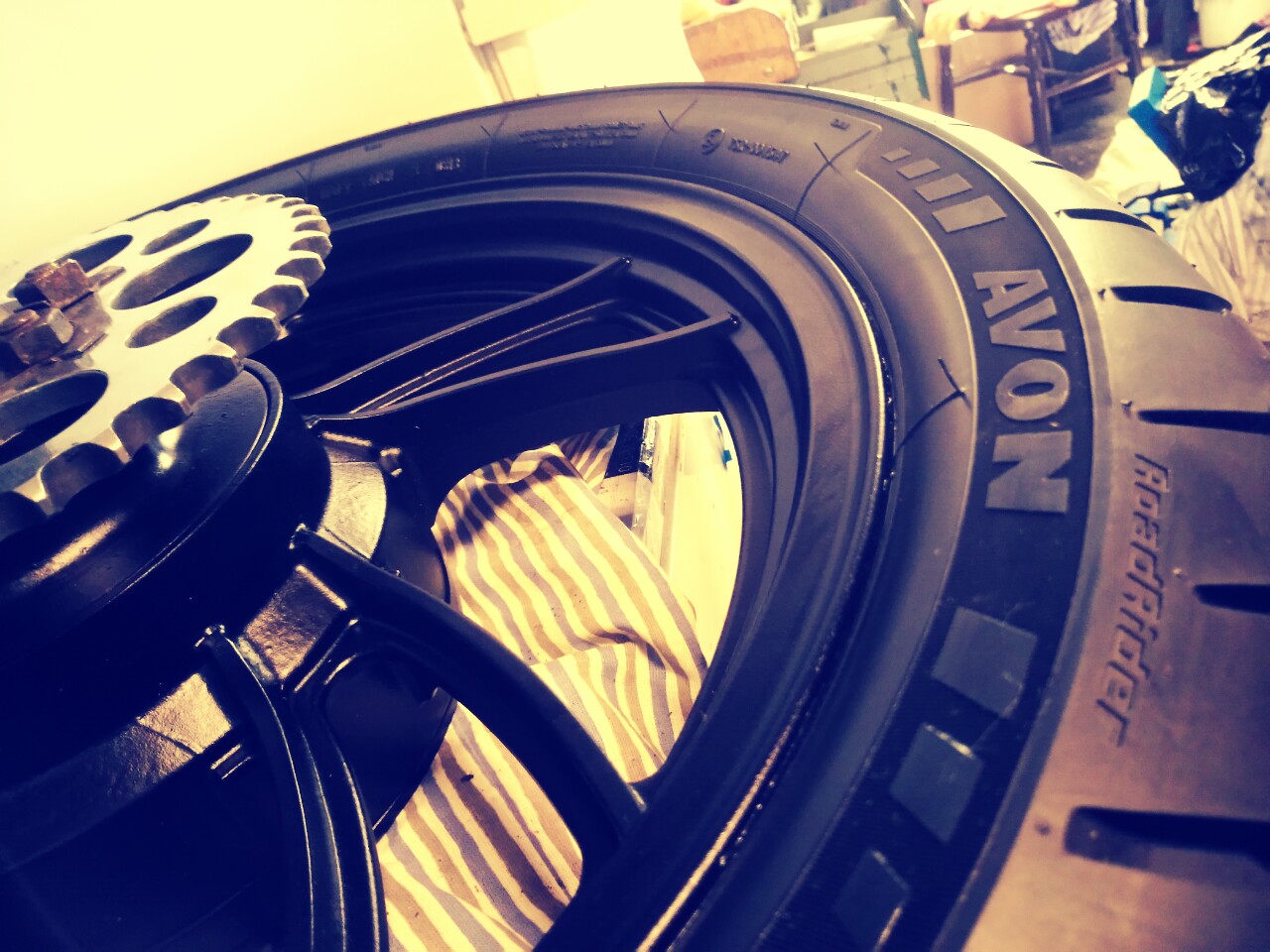

    Wheels :
    New bearings and seals.
    New tires (Avon Roadrider).
    Powdercoated satin black with white decor.
    Blasted and Painted calipers.
    New piston seals.
    New rear brake shoes.
    New stainless braided brake-lines.
    Semi-polished rear sprocket.

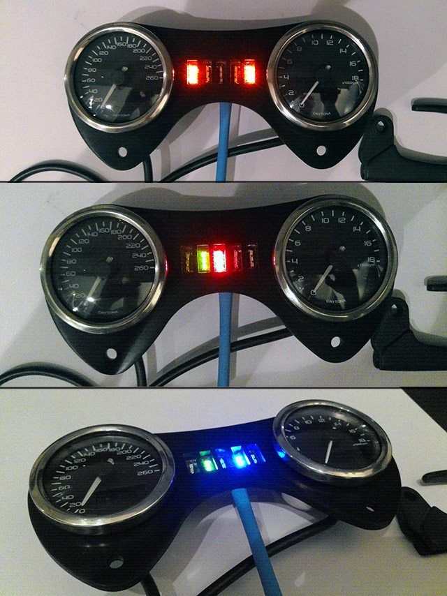

    Electric :
    Custom made "idiot-lights"-pcb with leds (turn signal, neutral, high beam and oil warning).
    New led turn signals.
    New Turn signal relay for leds.
    New clutch-switch.
    New Custom Brakelight Lens.

    Can you talk a little about your gauges, are those euro spec or did you pull then off another bike.
  16. broberg
    broberg Member
    216
    Sweden, Östergötland
    The gauges are Aftermarket Daytona Velona, ca 60mm in diameter, so quite small compared to the original ones. They are universal so you just have to choose mp/h or km/h in the setup. I am however having some difficulties with the tach, can't get good enough readings, I may have to splice one of the wires to the coils.
    Here's a link to the manufacturer :
    http://daytona-global.com/products/?pag ... categID=14
