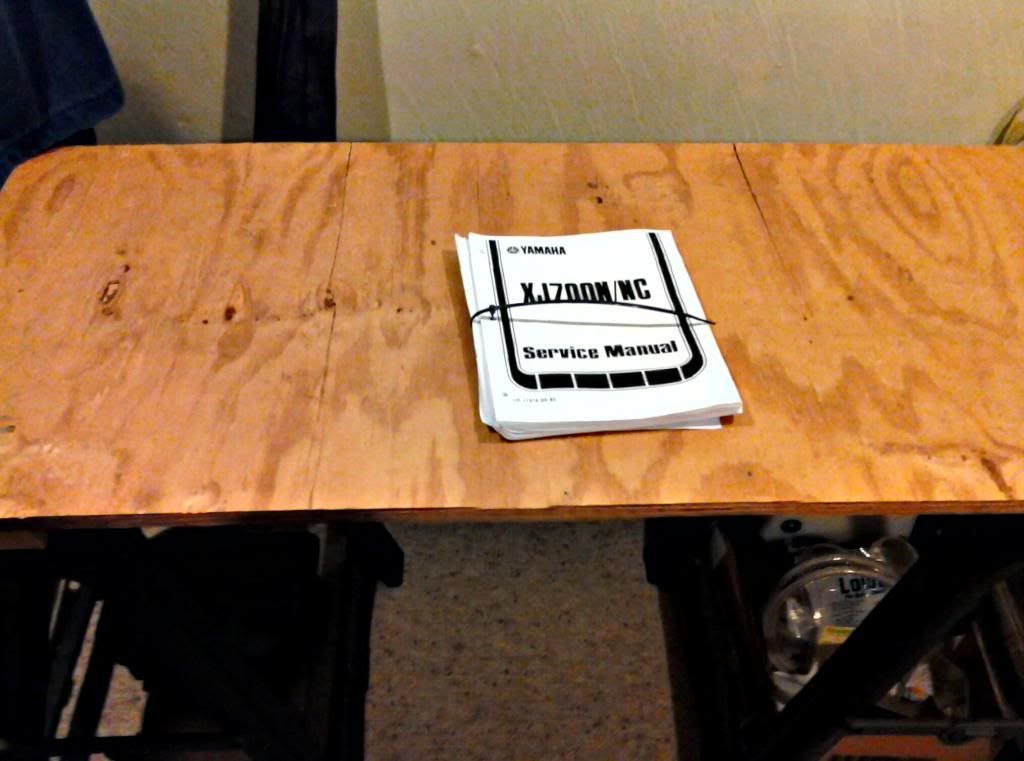

    Yesterday I setup my workbench that will be solely dedicated to my bike repair endeavours (well, two saw horses and a sheet of plywood; but dedicated nonetheless). Then I had a beer. Ahh, I can already feel the bike practically repairing itself!
    Note the repair manual just screaming to be used and abused all bound up with zip ties and whatnot! I've discovered that it likes it when I talk dirty to it. It "literarily" started curling its foot-notes in "unbound" passion when I said to it, "Don't worry baby...I'm gonna' grease you up really nice". What a naughty little manual.

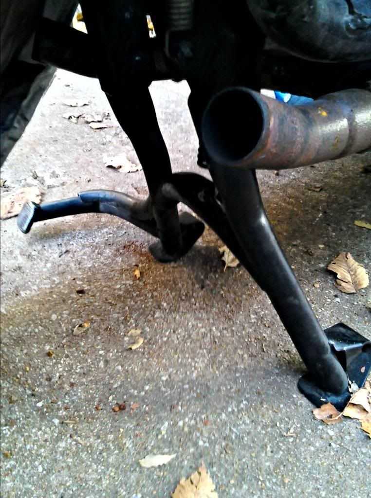

    Today, I installed the center stand. That spring was kinda tough at first; but then brain over brawn (or leverage over muscle at least) prevailed.
    I hooked one end of the spring onto its mount point on the center stand. Then, I slipped a box wrench over the hook on the other end of the spring and leveraged the wrench up and over the horizontal mounting post (effectively pulling the spring with it) and it hooked right in place. Piece of cake and my first of many (I hope) small victories with this bike.
    8O Ejpt 1
    :twisted: Bike Demons 0
    Let me entice you back tomorrow with spellbinding pics of the almighty center stand that I tricked into practically mounting itself!!! (I had falsely promised that it could spend the rest of its days "leaning on the job" like a lazy side stand (instead of holding up the bike like the Charles Atlas that it is) if it would only kindly allow me to put it back under the frame. You know what? My fork-ed tongue deceit worked! It went right after that carrot like the dumb ox that it is! HAHAHA! Joke's on you center stand!)

    First thing's first though. Behold! The center stand!

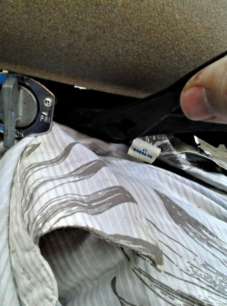

    I don't know it there's supposed to be some lever to lift the seat; but it took a minute to just get the seat pan off! Guess what? No clip!
    I put an old shop rag down just in case gas was going to spew forth.
    Easier than I thought...Came off without a hitch...Even the lines slid off easily without needing to break their seals...Nice!

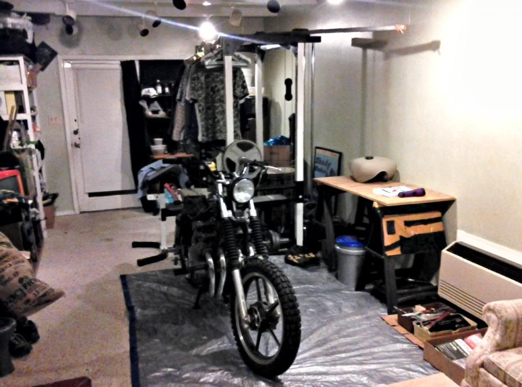

    OK! I'm back everyone and rain be damned!!! If I can't go outside to work in the weather, then I'll just bring the bike inside!
    Behold! My new motorcycle repair shop!!!
    Well, that's enough work for today...Now where did I put that beer...

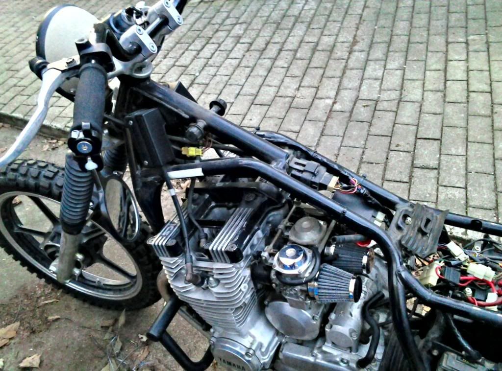

    Alrighty. So I pulled my valve covers and the ignition cover. Here is the pictorial odyssey of the event!
    Behold! The valve cover! (Looks foreboding doesn't it?!)
    Before I can remove it we'll have to get through that octopus of spark plug wires. They were conveniently numbered 1-4. Easy as pie and I can be thankful it's not a 12 cylinder.
    I was feeling rather festive and decided to lasso those unruly wires together with Christmas ribbon complete with a bow of good cheer and curled ends for added jolliness.
    Upon closer inspection of this black cover of mystery, all that was separating me from victory was a few measly hex bolts...pffft! Mere child's play when I have the power of the "Lefty Loosey" mantra on my side! I unscrewed them a little at a time in a star pattern to prevent any undue stress on the gasket.
    The inner bolts were removed and came out with ease. I arranged them on my workbench so that I could put them back in the exact holes from whence they came. After unscrewing the outer bolts completely, they were still held fast to the cover my some great unexplained force!
    The valve cover came off with ease (the gasket is brand new as was recently installed by the PO).
    One snug fitting bit is worth two easy-outs.
    I removed these bolts a little at a time as well (in a star pattern to prevent any possible stresses). The ignition cover gasket has some superficial cracks around the bolt holes. Thankfully, it won't affect the water-tightness of it.
    So there you have it folks. Tomorrow, I must journey far and wide in search of the elusive feeler gauge. Perhaps I'll cross paths with a hemostat too and come back to the garage to gap and pull those shimmys!

    Here are pics I took of the intakes. The first is one with a rubber plumbing joint fitted over the rear of the carb to act as a carb to airbox boot. I was trying to find a cheap way out of buying new, supple air box boots:
    Had tuning issues, so then I gave up and ordered the proper part.

    That's exactly what I was referring to. Upon close inspection, you'll see that the original airbox-to-carb boots are really velocity stacks on the inside, not just straight tubes. They don't end at the airbox flange, they continue past into the airbox with the "bell" ends of the stacks. (Velocity stacks don't have to be metal.)
    They only look like simple rubber tubes.

    Also note, in the pic, how the OEM boots actually mate with the carb opening. The metal rim of the carb opening is completely covered. If PODS or make-shift boots simply fit over the carb opening, and don't have a groove cut in to make the smooth transition like the OEM boot, you'll get turbulence right at the edge carb opening. Note how all of the air jets and air to the diaphragm/hat are at the edge of the carb opening, where they will be affected by the extra turbulence.
