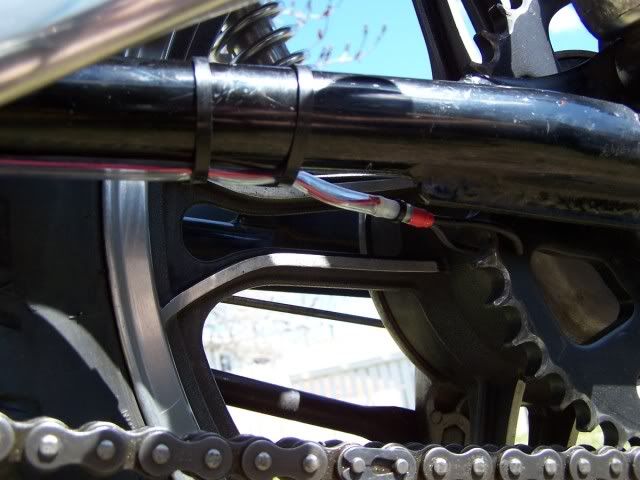

    Since I put on mostly touring miles and I have no center stand (Yoshimura pipe), I was getting tired of chasing my bike across the parking lot every time I needed to lube the chain. I bought a Tutoro system for @ $30.00 and installed it a few days ago.
    I've only put 50 kms on since, but it appears to be doing the job. I'll let you know what I think after a few long rides.
    PS At the end of last season I noticed a leak under the bike. I suspected maybe a shift shaft or trans output shaft seal leak. Turns out it was just the new chain lube I had switched to. What a freakin' mess under the countershaft cover. I hope the oiler will keep it a little cleaner.
