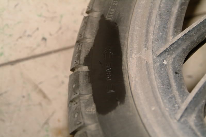

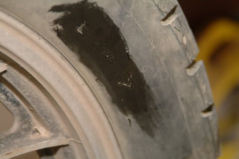

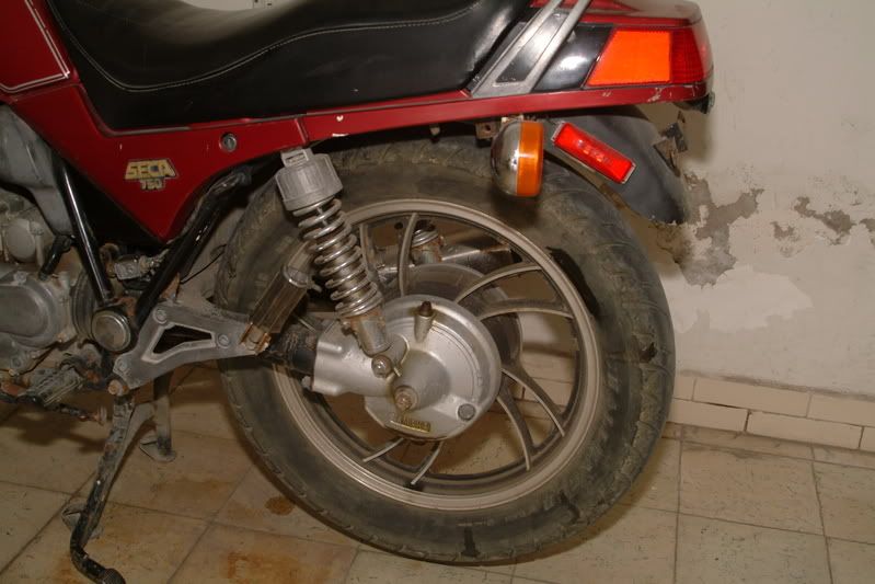

    But I was looking at it today, and noticed that the tires (Challenger by Kendo) have the indicating arrow pointing the wrong way.
    Both tires have the arrow pointing backwards.
    Is there a problem with this? I suppose that they won't work as well as they should, but... Is it dangerous?
    I only ride it occasionally, Should I take it to a mechanic so the tires face the right way?

    As I understand it, reversing the tire rotation from it's designed direction leads to squirrely handling, not a safe condition. I'd get those tires switched back before something unpleasant happens.

    According to our Avon rep, the arrow has to do with the direction the belts lap. If I recall correctly they directional arrows set the tires up so that acceleration tends to tighten the rear belt and braking tends to tighten the front belt. In this case it would make sense to switch them.
    I saw at least one manufacturer web site that stated that changing the direction the tire was originally run at was bad. The arrow was simply to ensure that if it was re-mounted it wouldn't be reversed. In this case it would be best to leave them alone.
    How's that for an answer?
    If it were me I'd go easy on them until I got them replaced. Odds are they're old anyhow.

    Hi amigo, read the section 'removal & fitting of tyres' it is not the least bit ambiguous. TYRES Wiz.
  5. bigfitz52
    It's not just the belts it's the tread pattern, the "V's" are pointing the wrong way... The tires don't look all that worn, if you plan to continue to ride on them I would most definitely have them mounted correctly as soon as possible.

    If you plan to replace the tires you can do a lot better than the Kendas. I would recommend Dunlop or Avon myself, I believe Yamaha fitted Bridgestones originally.

    After further checking, I saw a "477" on the rear tire.
    If not mistaken, that would be the 47th week of 2007, November 2007.
    Right? So the tires are not THAT old. :D
    So the PO changed the tires, but put them backwards... :?
