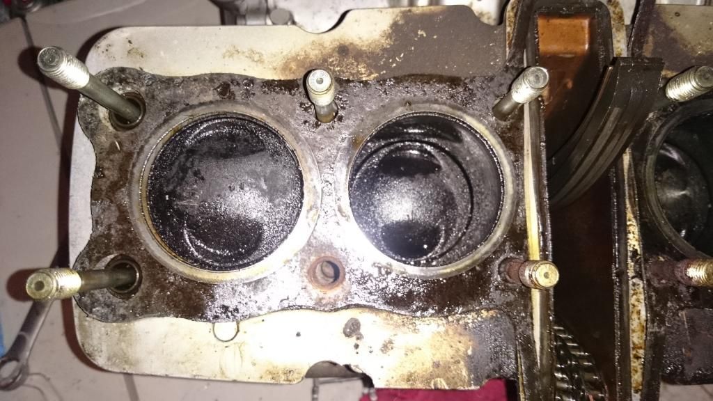

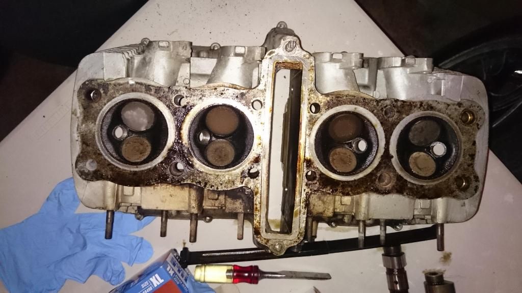

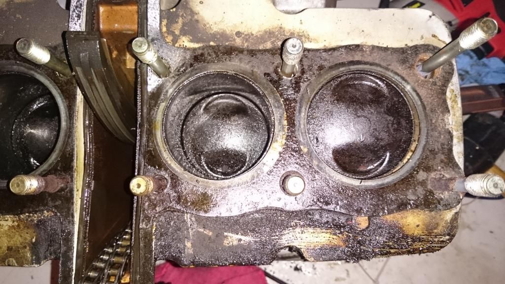

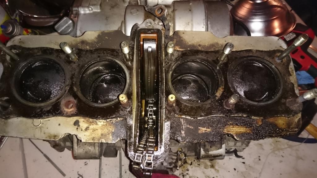

    Well, I finally pulled off the head.
    These are the photos.
    That stud at the top.. I broke. Nice! +5 Points!
    Cylinder 4 and 3
    Cylinder 2, and 1
    And the the overall picture.
    There seems to be an oil surface on the bottom of the head, and the head gasket looks to be in really rough condition.
    I think this was a leaking head gasket.
    Cylinder walls look nice and shiny though. I think ( but will have to check ) that the jugs are with in OEM specifications and they may just need to be honed + new rings.
  25. Bigshankhank
    Bigshankhank Active Member
    908
    125
    Bastrop, TX
    Hopefully all you need is a hone and can reuse your rings, but now you need to figure out how much of the stud on #3 is sticking above the cylinder base mating surface, and hope you can get the remains out. Heat and penetrating oil are your friends. I was able to get all but one cylinder stud out of my original engine, but one just twisted and twisted. My only hope for it would be to take it to a machinist at this point, but in my case my engine is completely disassembled. Hopefully you don't need that much work.

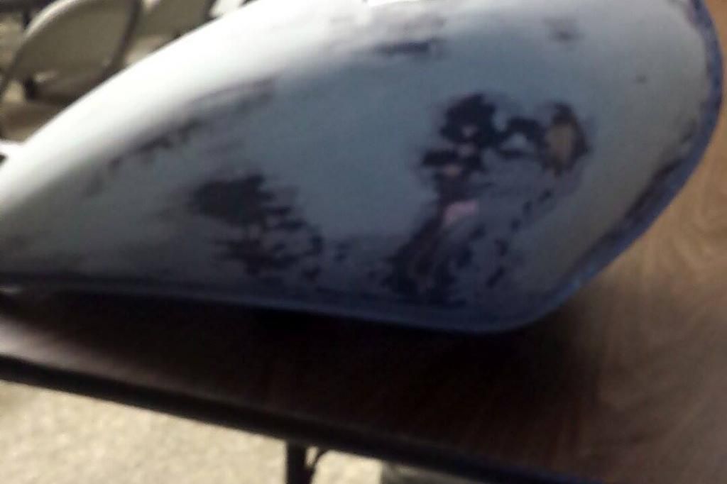

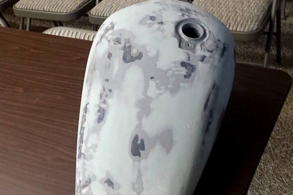

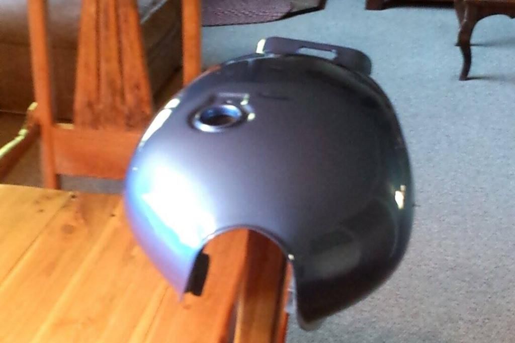

    A few months ago I gave my friend Loren my motorcycle tank and side panels to paint. He has been working on them little by little ever since.
    These are the results.
    He ended up starting to sand it down because we assumed it had 1 layer of paint.
    It had 8 layers of paint.
    So my pal Loren decided to sandblast it, and he found rust holes. It also had been dented in on the left and right and was filled in with bondo previously. So he popped dents out, did a bunch of body work and repainted it.
    The paint code is 6W, it is a mazda miata paint color. ( Laguna blue metallic )

    Alrighty,
    So I dropped cylinders and pistons off at the dealership for a hone + measure.
    They said that #3 cylinder has a bit of surface rust that won't be honed out.
    Besides that everything is fine. I think I'm going to soak the cylinders in diesel after they're honed, and then wipe them clean again so make sure everything is ok.
    Apparently diesel will loosen any rust easily. That or the piston rings will just scrub the tiny bit of rust away too.

    So.. Update time.
    I have received everything I need, except cylinders that are good. I did find another new to me set without rust in them, with low miles. *wishful thinking*
    I still need to mail the rust pitting cylinders back.
    As for gaskets and such, I've received everything from Charcal. Now I'm slowly trying to remove 34 year old, 50,000 mile, baked on from the flames of hell, gaskets. I tried razor blades, and just couldn't get it off without gauging the metal.
    So I opted for http://www.amazon.com/3M-08574-Gask...=1421914891&sr=8-3&keywords=3m+gasket+remover which is a gasket removal spinning disc set.
    - Now it says to use an electric drill, but I found it hard to hold it steady, so I utilized my pneumatic tools and was able to attach one. I found that @75psi, this thing was batshit crazy and could rip though the metal pretty easy, but @25 psi
    you could easy take off what you needed, without taking off the metal too.. I have been starting with the most abrasive one to cut through the hardest of the gasket, and then swapping to a higher grit later for finishing it.
    I practiced on cylinder block mating surface and made them all shiny. To make sure I wasn't taking off metal I used a razor blade and shined a light behind it. So far it is working really well.
    You just need to be very careful not to balls it up. Best $13 I have EVER spent on a tool.

    I received the incorrect cylinders today.
    They had the YICs port, 1980 cylinders do not have the YICS port. >.>
  50. hogfiddles
    14,978
    5,260
    That's right.... 1980 was a non-YICS xj650
