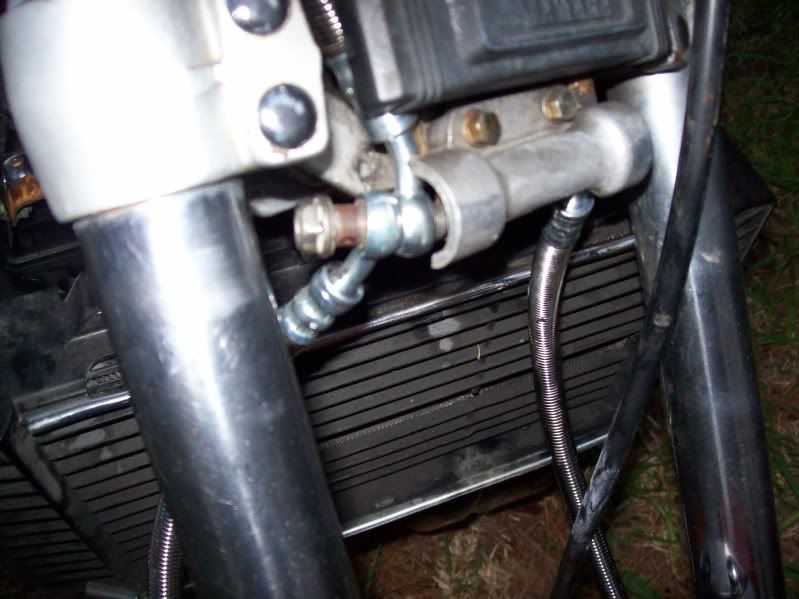

    Second when I received my new brake lines I noticed some nice instructions that said do not remove all the brake lines you will not remember how to put them on. Opps here is an inlcosed picture is this right
    I am not sure how the hoses line up at this connection[​IMG]

  2. bigfitz52
    Close.
    Bolt, WASHER, fitting, WASHER, fitting, WASHER, block.
    According to the fiche for your bike, you do have the hoses in the proper "stack up." You just need a copper washer between the bolt, the fittings, and the distribution block.
    Fiche, for future reference: http://www.babbittsonline.com/pages/par ... parts.aspx
  3. Chuck25
    Chuck25 Member
    55
    Thanks I did not place the washers yet so I would not loose them :D
