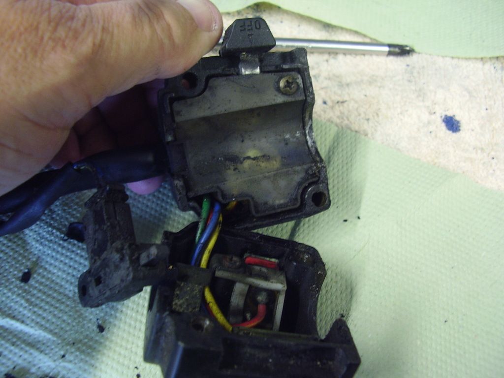

    how far did you strip the switch to clean the contacts?
    it seems the switch or contacts, my still be dirty.
    did you strip it this far.
    the switch contacts are just behind the centre ball bearing, in the middle of the pic. with the 3 wires attached, get some contact cleaner, and clean the slider up , then lube with some dielectric grease.
    stu

    Borrowed Stu's photo of major surgery, but wanted to add this note just in case:

    Rooster points out an incredibly important issue....those "arms" of the copper contacts tend to get bent "outwards" so that they no longer make contact when the slider is moved to the left or right......the entire contact gets kinda "V" shaped rather than a nice "|_|" shape......by the way, the thumb switch is ALWAYS supposed to be pushed straight inwards to either cancel the signals OR before using the switch again. Pushing the thumb lever straight in releases the catch on the slider and prevents the contacts from being bent out of shape......if you do get your switch apart as shown, "play" with the mechanism, see how it operates, and you'll see what I mean.
    "Look Out For" items:
    1) on many switches, the tiny screws that hold the various objects in place are different from each other (thread size and/or pitch), so make notes of which one goes where, they are all about the same size, and if you put the wrong one back you have instant thread strippage in the soft metal of the housing.
    2) as you dis-assemble, take careful notes and/or pictures as the routing of the wires and the hold-down clamps that route the wires, as it is not always intuitive as to their positions and functions.
    3) Don't man-handle the wires. The contacts where the wires terminate have somewhat weak solder joints and can break easily, and there ain't no putting that humpty-dumpty back together again.
    Honestly, just like periodic valve clearance checks and carb cleaning, dis-assembling and cleaning of the control switches should be a "periodic maintenance" task. A lot of crap gets in there over time, and for them to function properly, they need periodic cleaning.
    Most important point, though: ALWAYS push straight in on the thumb lever to release the slider catch after your signaling is done (even if the self-canceller has done the signal cancelling for you; the self-canceller is just an electronic circuit canceller, it does not and cannot affect the PHYSICAL position and activities inside the switch) and don't EVER move the thumb lever all the way from right-to-left (or, left-to-right) without pushing "in" when at the center position.
    P.S. the ball bearing is captured within the plastic slider and ain't going anywhere until you remove the slider latch plate (the ball bearing IS the latching mechanism!) and take it apart.......and at that point, don't lose it or the spring!

    and don't forget the plastic barrier plate, to prevent any metal parts coming into contact with the handlebars
    the "off" marking on the switch knob can be easily seen here, with the push arrow
    stu
