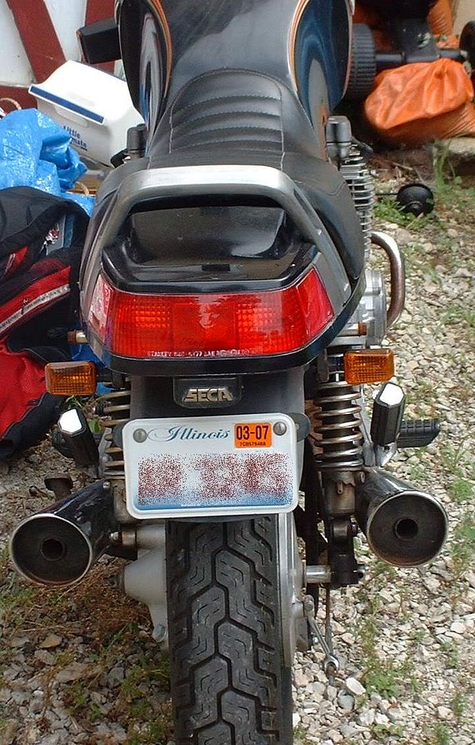

    I would doubt that a police officer or insurance agent would have any idea whether or not your turn signals were DOT approved, on a 25 year old bike. But here are the pictures:
  24. Speedwagon
    Speedwagon Member
    109
    Littleton, CO
    Oh, and after I put those rears on, I did some mix/match on the front, so my fronts are original. I couldn't find a decent alternative that would fit when I did this, so I left the front be. Don't know the brand, they were generics that the store had for about $10-15.

    Nice, I like those.
    Your right about the DOT approved thing, I get overly paranoid about ol' johnny law sometimes. Minneapolis cops don't have the best rep for being polite or leniant.
    I'll shop around and see what I can find, thanks for the heads up :)
  26. Robert
    I like your minies too! They look great on the tail end. I also noticed you have the acid induced corrosion on your rear frame and swing arm as well. Royal pain that is. All because the stupid tube poped out. Took me quite a few hours to blast and clean that up. Hope you get yours under control soon!
  27. Speedwagon
    Speedwagon Member
    109
    Littleton, CO
    What are you talking about? The bike came just how it looks with the rust, so please clarify that.
  28. Robert
    Ok. See all the rust at on the swing arm and swing arm pivot? Notice the relation to the battery box? It is from the battery acid seeping down onto the paint. After a while the acid eats the paint away and the rust takes off from there. Cause on my bike was the battery overflow tube fell off and the acid went to town on the paint. I was suggesting you tend to it before it gets too much out of hand. I had to pull the tire assembly out of the way to sandblast the area effected and then paint it. Did I explain it sufficiently? Hope so, looks like a nice ride. Let me know if I failed. All the best!

    Sounds like good sound advise from Robert about that rust.
    I'd suspect if it wasn't the battery acid that possibly that bike has had some bad exposure to salted roads but I think it looks like the batteryn to me.
    Nice bike
  30. Speedwagon
    Speedwagon Member
    109
    Littleton, CO
    No, sounds reasonable. Just had no idea about it. I figured it was just a rusty old bike! Guess maybe I have a winter project ahead of me then. :p
