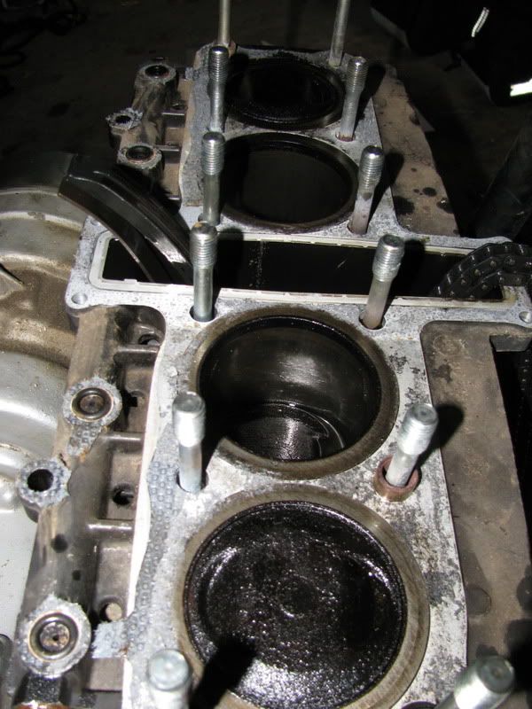

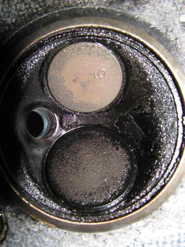

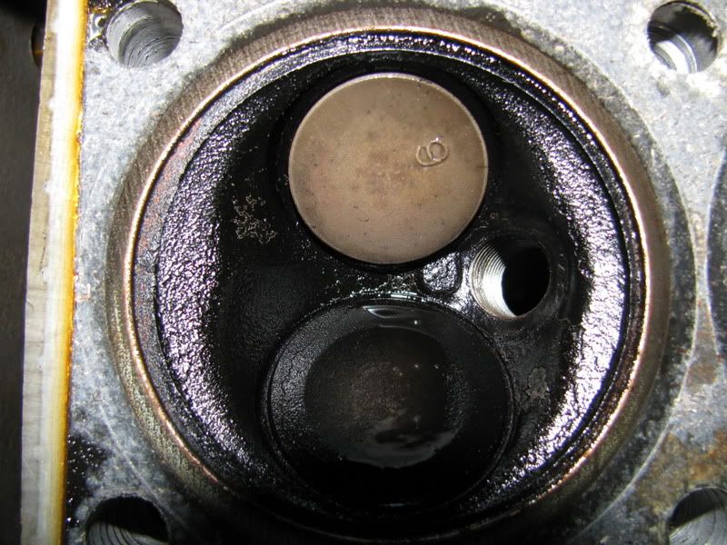

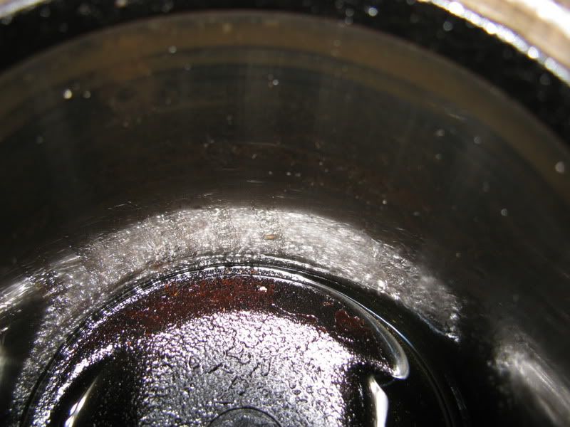

    well, i got the head off. Only took about an hour because I already had the valve cover and tank off.
    Looks like the head gasket took a beating and separated. I didn't remove the cylinder section because I didnt want to ruin that gasket too if i dont need to.
    Close inspection did show a VERY slight rusty color on the cylinder walls. Unfortunately everything is oil soaked from my wet compression test.
    I don't know what to look for so i took some pictures. I didn't know what to take pictures of so i just took random shots. Sorry the lighting is terrible in my garage. I'll get some better ones in the day light in a few days. Please make requests of what needs to be documented.
  17. bigfitz52
    In the very last pic, see that valve that's all bare nekkid and dry? That one's been hanging open from the looks of things.
    The good news: There's no really bad news here.
    The bad news: You got some work to do but nothing is F*ed.
    I will elaborate later my dinner is on fire...

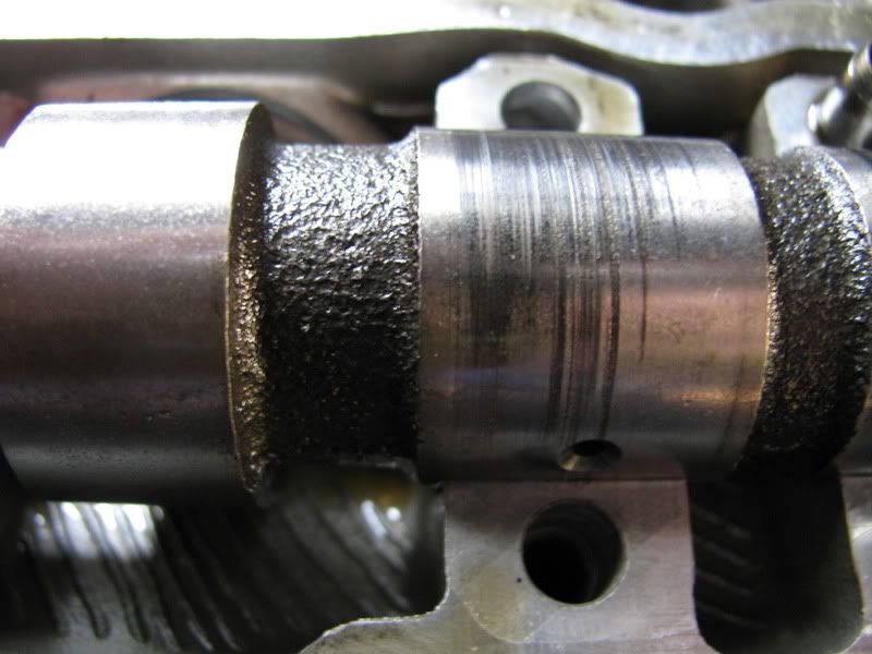

    Not a good vehicle week for me. My fuel lines went in my car today. Kinda stranded now.
    Anyway, further inspection showed this lovely wear on my cam shaft.
  24. bigfitz52
    URK. Somebody ran it out of oil (or low on oil.)
    Get another cam from a reasonably low-mileage motor off eBay, and don't fret it. It'll outlast the bike. The journal isn't toast, it just has a couple of new oilways. Seriously, the damage isn't on the real bearing areas of the journal, it will survive. Just be sure when you smooth out the "ruts" you don't gouge up the nicely polished bearing surfaces.
    You can disassemble, clean, and inspect the head and valves and decide then if you need professional intervention. You might just need to lap a valve or two, the special tool for that costs about $5. (A valve "stick.")
    You need the type of valve spring compressor that is a "tube" with the sides cut out; there should be a pic in both the Clymer or factory manuals.
    Really sorry to see this, that kind of damage on a low-mileage mill makes my tummy hurt. RPGoerlich got ahold of a 550 max with something like only 5000 or 7000 miles on it that two holed pistons.
    The good news is you should be able to resurrect it without spending horrible amounts of money and once done it will last a good long time.

    Which cam is that? If it's the Exhaust cam I have one for the 750 Seca.
  28. mainexj550
    mainexj550 Member
    163
    maine
    Its the exhaust cam. I am going to try to run the one I have but if that doesnt work out or I change my mind I'll keep you in mind.
    Thanks

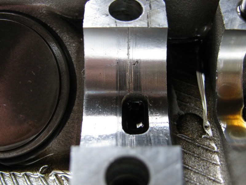

    finally had some time to pull the valves, clean the head, lap the valve seats and reassemble.
    All the seats looks very nice. no defects of any kind on the seats or the valves. lots of carbon as I mentioned before which I removed and am hoping is related to my problem.
    further inspection of the cam journal revealed a spec of something stuck, or some sort of build up on the journal, enough so that my finger nail can catch on it. Is there any safe way to grind this with a dremel?
  30. bigfitz52
    I wouldn't.
    That cam is torn up. Take Richard up on his offer; the journal isn't in bad shape but the cam is pretty nasty.
  31. mainexj550
    mainexj550 Member
    163
    maine
    Sorry, wasn't clear. Its the bearing surface on the head itself that has the build up.
  32. chacal
    9,162
    1,973
    +100-squared on the Fitz recommendation......
  33. bigfitz52
    Sorry; you're right, I didn't catch that detail.
    However, the cam still looks scary, the journal isn't damaged in a critical area.
