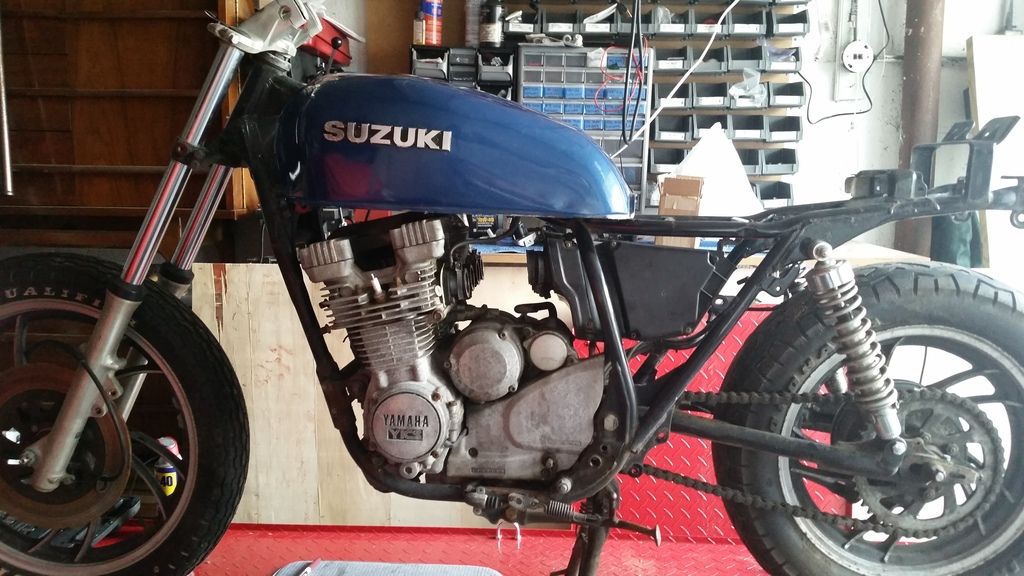

    Hi,
    Could anyone post a pic of the side/kick stand of their 81 xj550?
    I assume other bikes will be the same.
    I am trying to figure out the spring and apparently there is another part involved but I don't recall the setup.
    The spring, the one I believe is my stand spring, alone appears to be too short.

    Yes, that's what I see in exploded views but I don't remember taking it apart like that.
    actually, took me a bit but i found an image. close up would be great though
