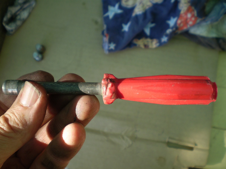

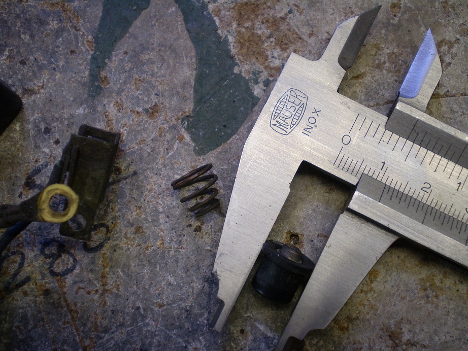

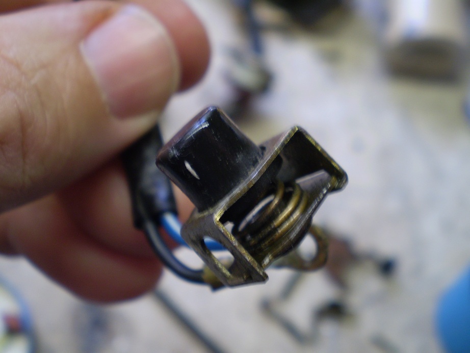

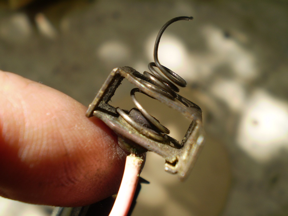

    This may be a bit late but I was looking for a button too and couldn't track down one without buying the whole switch-block so, what the heck, time to make one with the rudimentary lathe(aka drill, vice, hand-files and the bench-grinder) and some old bits and pieces. It worked out much better that I expected so here are some pics of the process.
    Original button is from the horn, size and idea of parts from here.
    Plastic is from an old socket hand tool that I have no idea where it came from or what I would use it for but it was in my toolbox, so fair-game.
    Spring was made from a short length of high tensile wire... I can't really say where that came from but maybe it was picture hanging wire?
    Horn Button.
    Horn Button dis-assembled.
    What was left of the socket hand tool after the rudimentary lathe work on the end of it.
    Making the spring into a cone shape after fashioning it around a screwdriver shaft. (lots of tweaking and two sets of long-nosed pliers involved)

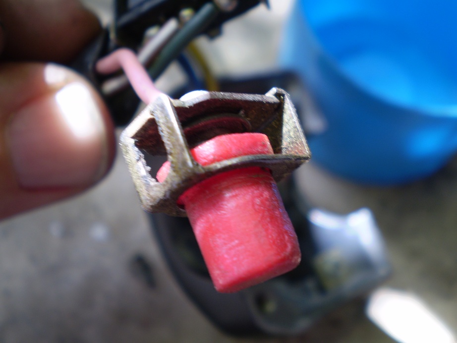

    The button put together, I swapped the horn button to the starter and used the new one as the horn button.

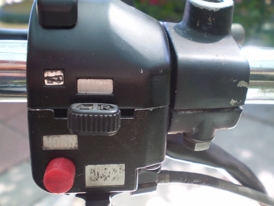

    How it looks in the switchgear.
    Just have to work out how to fix the original stickers or find new stickers to suit now and a bit of a clean up, but the button works a charm and... ok it took little while to achieve and if I would have known it was going to actually work out I would have chosen a better piece of plastic to work but all in all I think it will last the distance and it looks pretty nifty being red too!

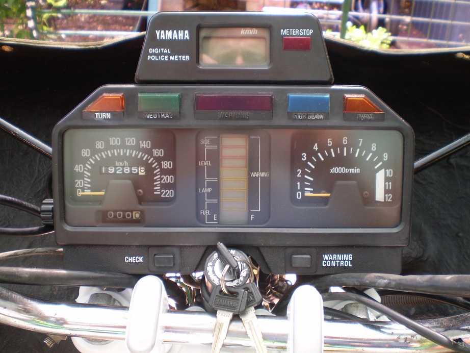

    Hehe I haven't seen a radar attachment anywhere?! But I think it calculates its reading from the tachometer somehow, I haven't actually had the bike on the road as yet so, it is a mystery although I know the patrol switch locks the gauge when you get the offender at the right maximum speed to book him!
    I can see myself pulling up beside people shaking my fist and pointing at that gauge saying slow down damnit! :wink:
    As far as the engine is concerned the same thing applies but my neighbor did think that I was having trouble starting a lawn mower up until recently when I managed to get all '4' cylinders firing hehe so I'm happy no matter what but if I find out I will let you know :)
