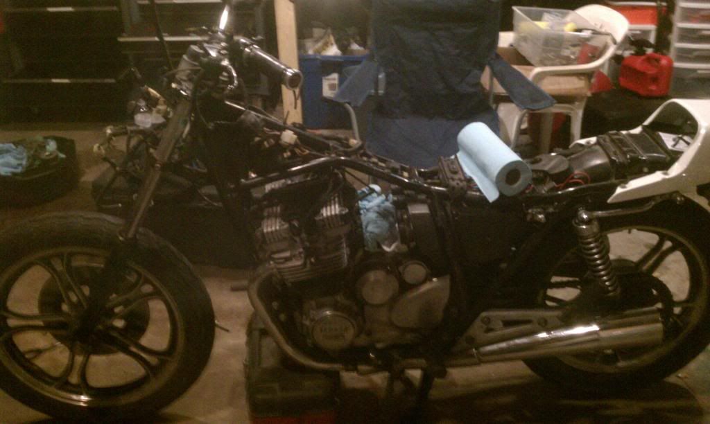

    This is what my bike looked like about a week ago.
    I cleaned up the carbs and adjusted the chain and that was about it. Enough to get it run and go. Then i discovered a few problems. Like the stopping power was enough, but borderline scary, gas in the oil ETC.
    So i parked it and started taking it apart to inspect and get EVERYTHING fixed.
    *sigh* heres what it looks like at the moment
    Somehow its been the most depressing, exciting, and frightening thing ive done in a while taking this thing apart. but its actually going pretty smoothly.
    Like i said, youll probably have alot of work to do. So DIG IN!
    Or as my buddy refered to it with the bike "Shit yer pants and dive in!"
