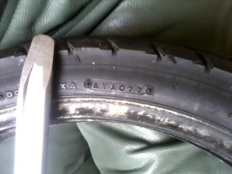

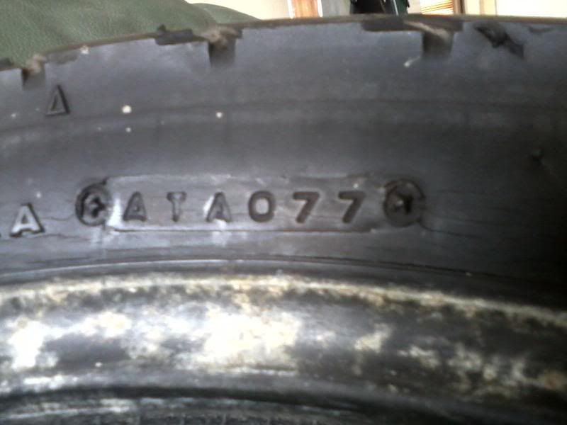

    Just thought I'd post up the date code of the front tyre that was on my XJ when I bought it. As far as I can tell, 3 digit code with no triangle means 1980's so my front tyre was made in February 1987. 26 years old 8O
    Guess as the bike's '83, at least the original owner paid attention to tyres & replaced when the originals were 4 years old...
    This came off a bike last on the road around 2 years ago! Best of it is, there's hardly any sign of cracking/checking so anyone just looking the bike over wouldn't have had a clue how bad it was...

    Hardly any cracking?!?!?! There's plenty of it visible in the pic you posted! I wouldn't ride on that. I don't like to ride on tires that have ANY cracking.
    Personall opinion.

    Dave, if you spotted the cracks surely you spotted it's also no longer fitted to the wheel! :D it's not the condition so much as the age that scared me.
    And most of the cracks didn't show before the tyre was deflated & removed, the act of flexing the hardened rubber in removal was enough to do that! :?

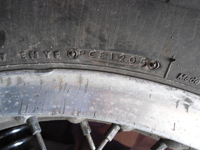

    All right, here is my '77 XS650 rear tire date:
    No problem with this one year is 2005, eight years old is fine for me because I don't ride that bike very often neither fast. But what are the PCE letters mean?

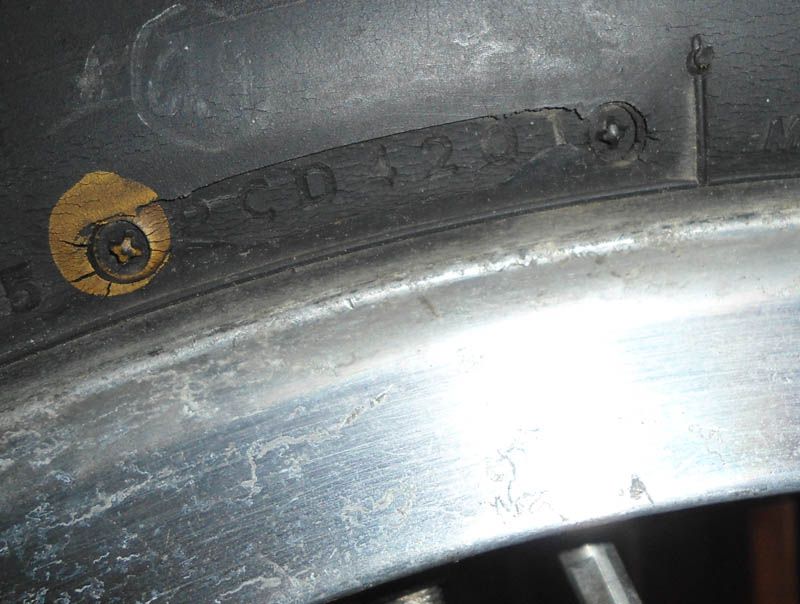

    Now the front tire:
    That one shows some cracking and is 12 years old, definitely has to be changed soon. Again, what about the PCD letters?

    What brand of tires are they? I believe that's a manufacturer-identifier code, but I'm not 110% sure.
  19. quebecois59
    Re: Who has the oldest tyres?!
    Both are Bridgestone Spitfires 11.

    On the letters I'm not sure, will see what my Avon rear has on it. The front (ATA) was Yokohama...
