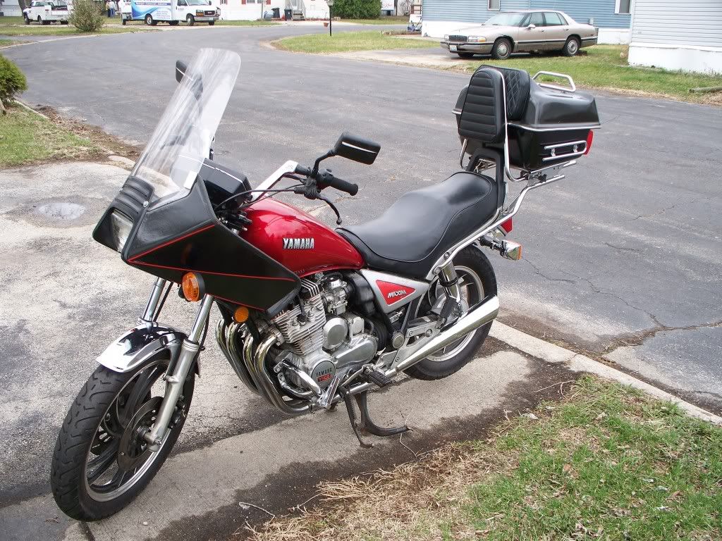

    Don't know a brand name. But my parts bike came with an 80s universal (low) passenger back rest / luggage rack.
    It bolted right up. Other members had same combo with the high back rest. Below is the parts bike as purchased.
    Fyi I installed the setup right away and swapped trunks.
    P.s. I've also seen them on eBay occasionally

    I've got a set very similar to the one Metal_Bob posted -- looks like they're both from KG Engineering - they made tons of multipurpose racks and rests, and went out of business LONG time ago.
    The one I've got I call a tour pack though - it doesn't have the adjustable backrest like Metal_Bob's does, mine's fixed. But it does have hard saddlebags (with brake & signals) and a trunk with brake lights for on the luggage rack. I've got pictures, but the site won't let me upload right now :evil:
    They turn up on ebay from time to time -- sadly with the age of our bikes now, unless you or a friend are handy at fabricating, it's about the best we can do.
