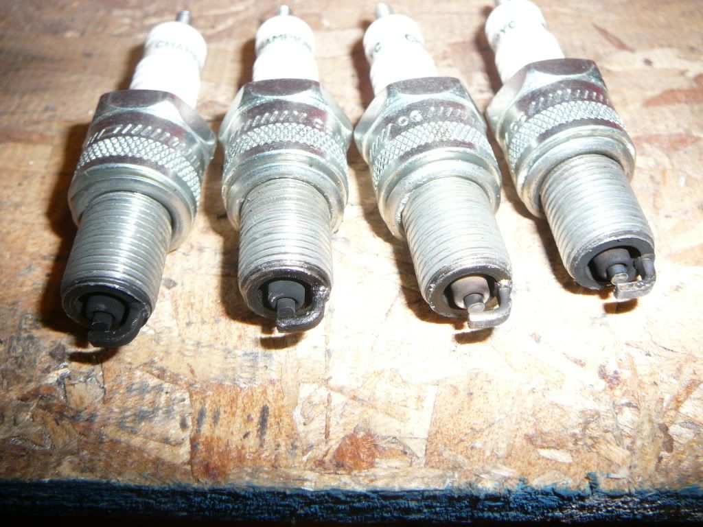

    I was expecting the bike to be lean, not rich. I checked all the plugs again today and they all look similarly black with #1 being the worst and #3 almost being perfect. I' ll post a picture of the plugs.

    The plugs in the picture are in order 1-4 from left to right.
    I just stuck my nose in the crankcase and I am smelling gas in the crankcase so it's definately a problem with my floats sinking or seat not sealing. Somehow fuel is overfilling the bowls. Looks like I'll be pulling the carbs again.
