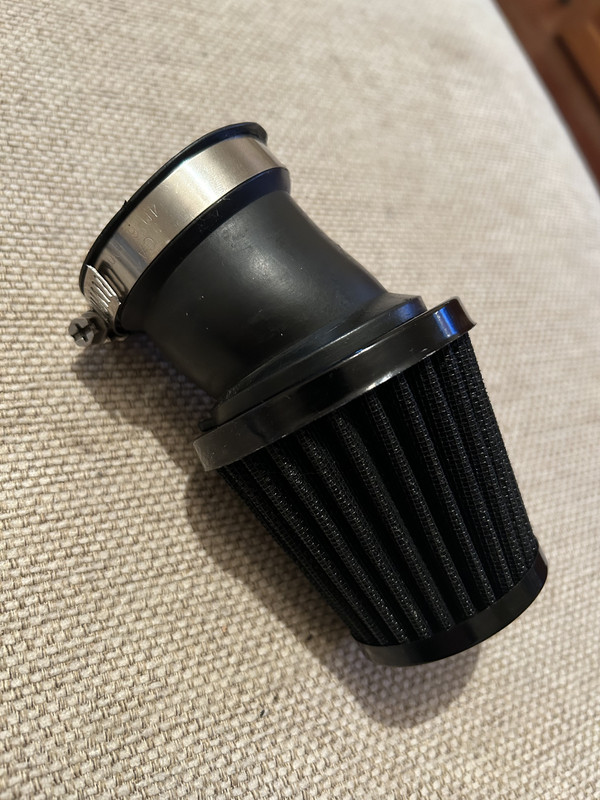

    Also what pods do you have? I have K&N and found the cheaper brands can sometimes block the air inlet when they are pushed onto the carby, that could be your issue so check the inside profile of the pod isn’t blocking the air slot on the front of the carby when it’s in position.

    By air inlets you mean about these?
    https://postimg.cc/gw0N8bFm
    What buggs me from the very start is that the spark plug pipes and spark plugs are with resistance :cool: I’ve read that the spark plug pipes should be with resistance(service manual says the same) but not the spark plugs :cool:

    Yep, there are the air inlets. I personally like Iridium plugs, these have resistors built in so you shouldn't use them with stock plug leads that have a resistor in the plug end.
