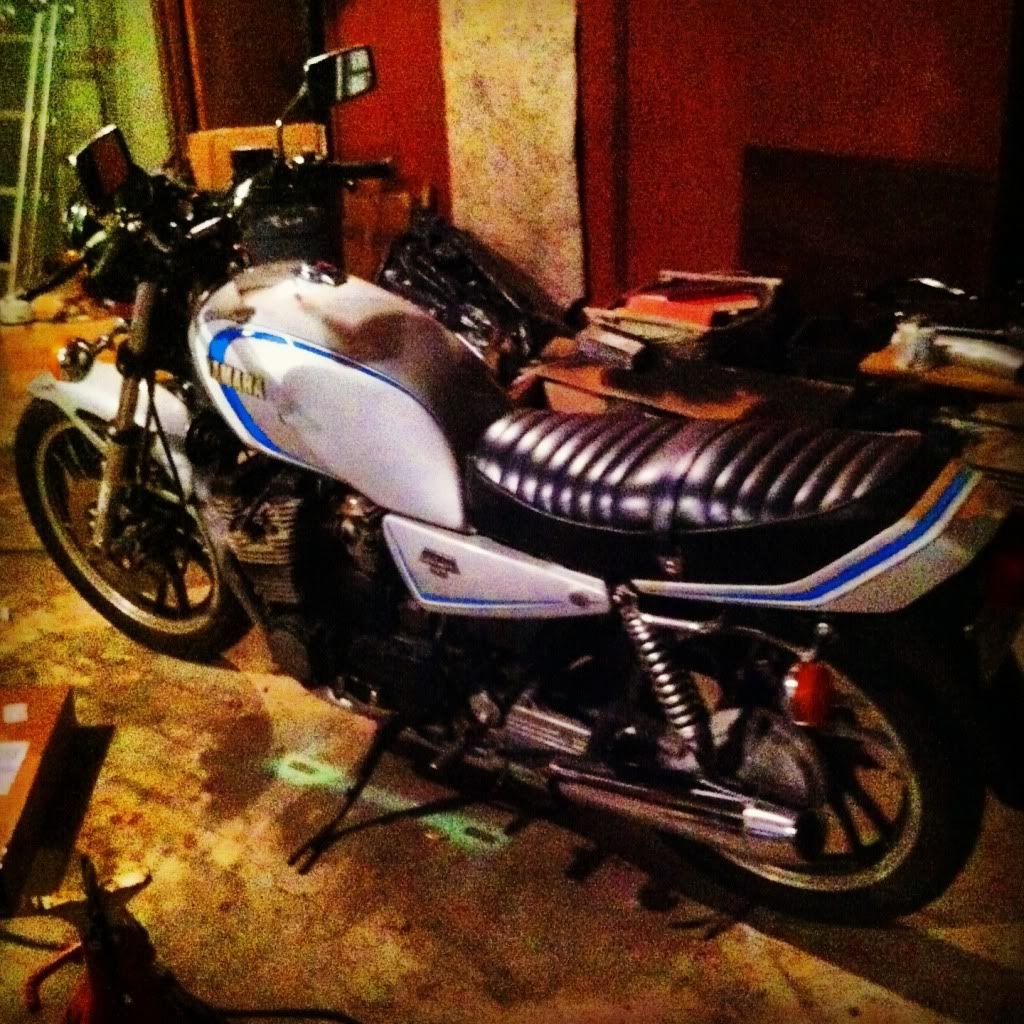

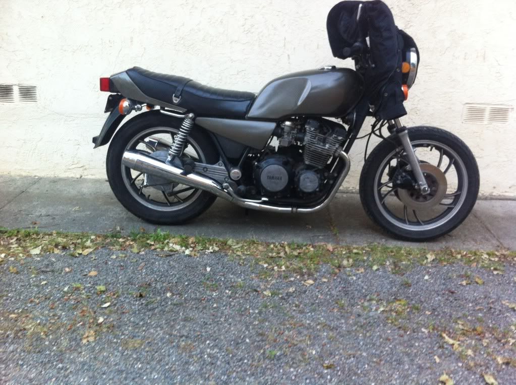

    So I'm going to start a thread for my XJ650RJ to help myself remember what I've actually done to it. It's been a slow process, but with a few more months of summer, I'm in no rush to get it done. Winters in northern california aren't that bad anyways...
    Heres when I first got her. Terrible picture, but she wasn't in the best of shape. Tires cracking, terrible paint, but she seemed to run okay apart from a flat spot at the higher rpm range.

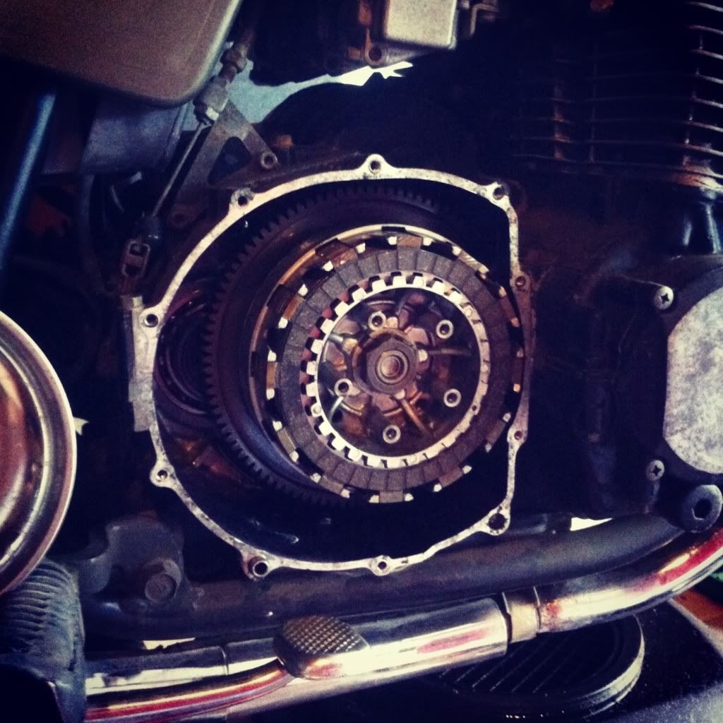

    Then I replaced the clutch. It was slipping, and although the friction plated looked mint, it definitely needed new springs. The adjustment was tough, but worked out.

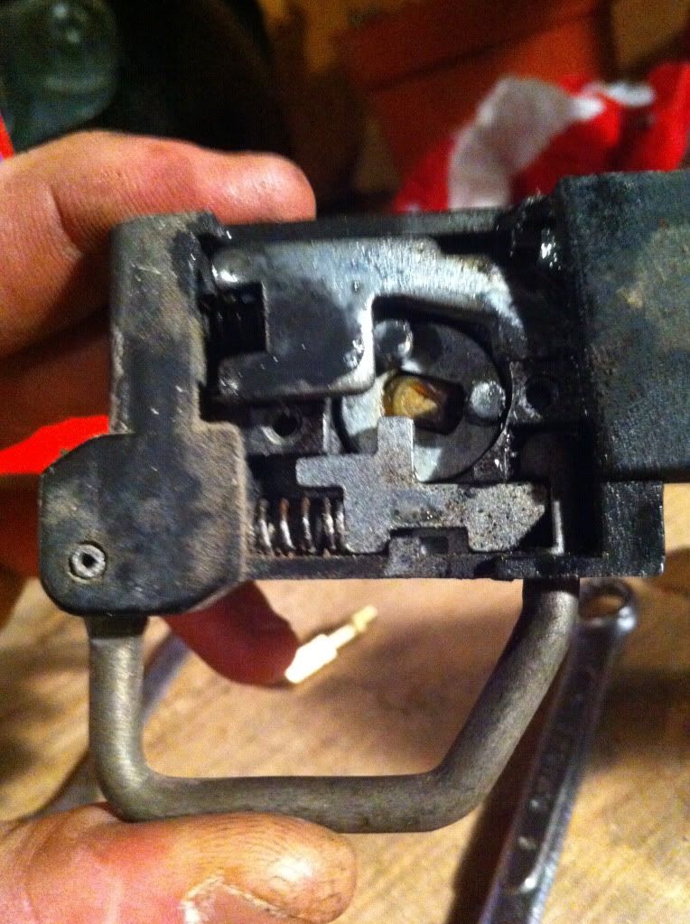

    I went through the whole bike and rebuilt all of the lock cylinders and little latches. None of this stuff worked, but now it all seems like new. I'm still having a helluva time locking the handlebars, but with enough jiggling, it wil eventually find its place.

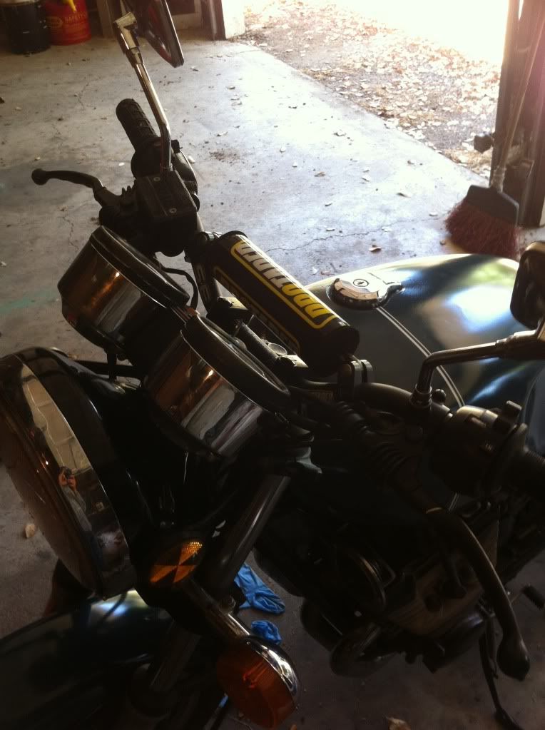

    Added some pro taper-bars. They change the feel of the bike dramatically. I actually really enjoy the change.

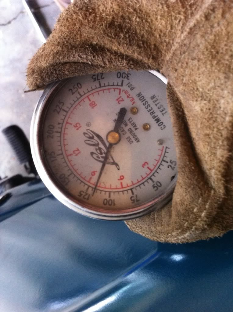

    Checked the compression...
    Not too shabby from what Ive read. It was a dry test-no oil. All within 2% of each other.

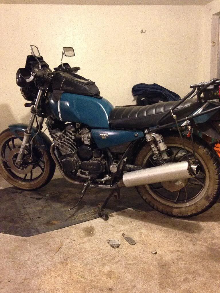

  6. lacucaracha
    lacucaracha Member
    359
    Napa, CA

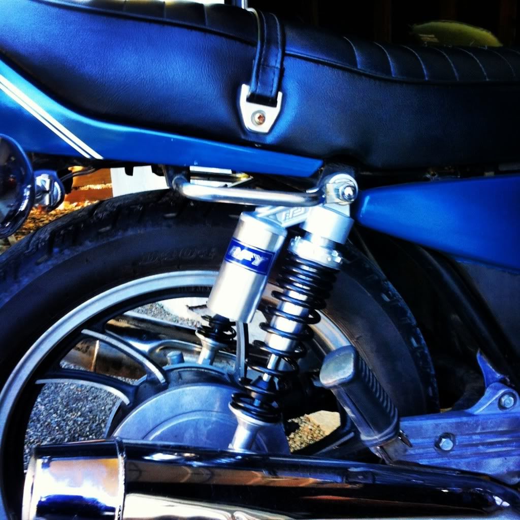

    Got some new shocks on. Cheap-O ones from EBay, but they are a whole lot nicer than my old shocks.

    Thanks for all the carb advice. Senior Chacal is where I've gotten pretty much all my parts thus far. Shipping is awesome.
    As far as the shocks, they say "RFY" on them, but I think it's a fair bet to say those letters were chosen at random by a Chinese company. They are readily available in an assortment of colors by a few different sellers on EBay. I bought from a guy in Southern California because it was close.
    Here's the link: http://item.mobileweb.ebay.com/viewitem ... 0825770896
    You get what you pay for. They feel great now, and have significantly tightened up the rear end with a preload of only 1/4". Unfortunately, they're really good at pointing out how badly I need front progressives and an upgrade to 15w in the front. Jumping on the bike, the front seems soft, and it's worse when you hit a bump mid corner. After upgrading my front, I think I can give a better review. At the (somewhat) low price, I would probably buy a new set over rebuilding them when the time comes....

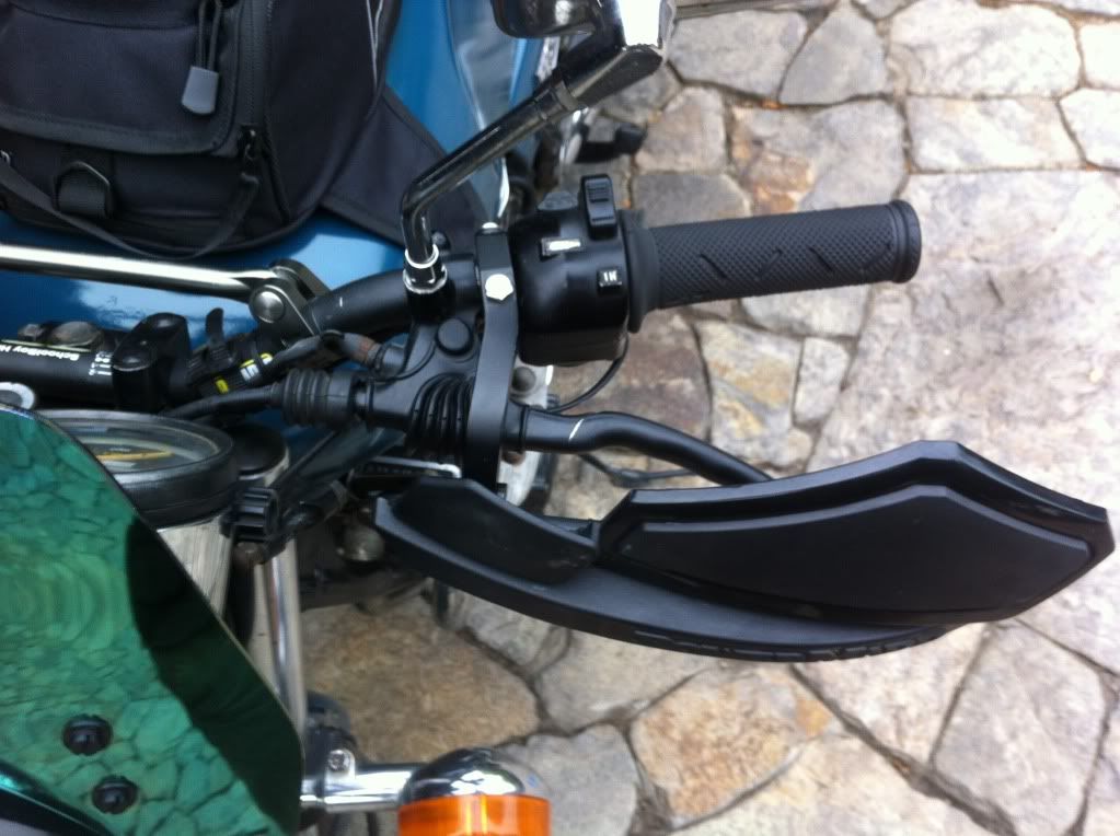

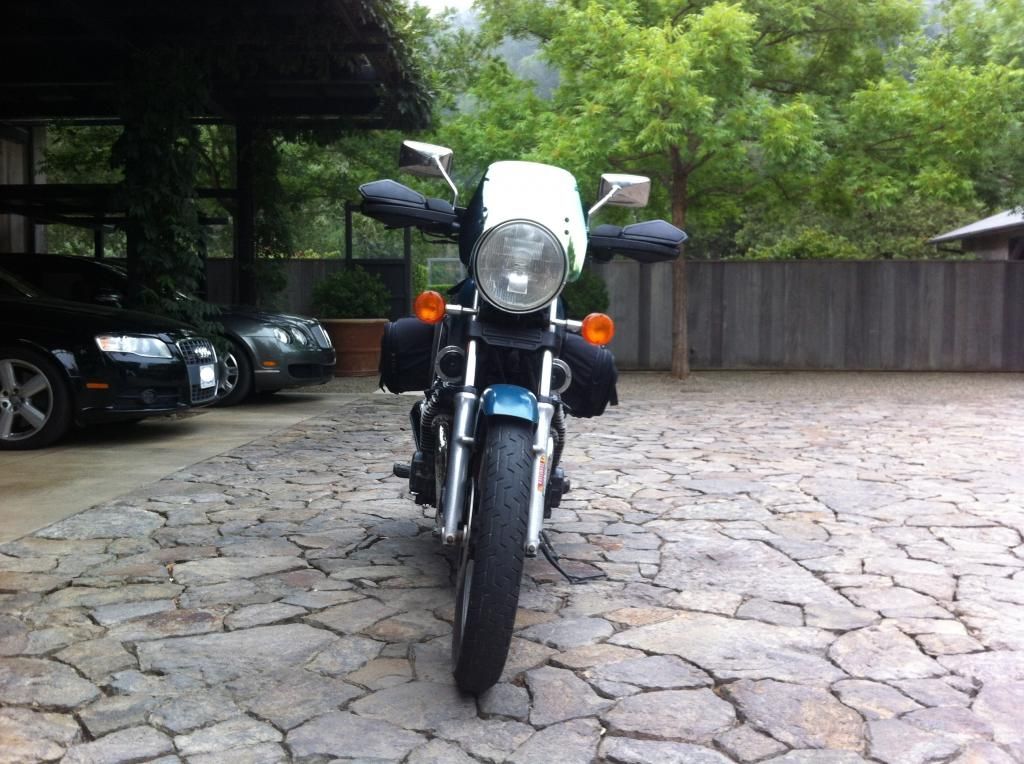

    Worked on a couple more things. Soft-bags and hand guards. They really help calm some of the buffeting from the windscreen. Who knew?
    A bit crowded on the bars.

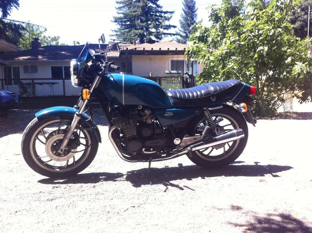

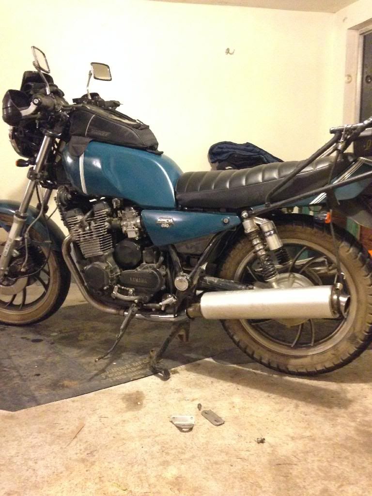

    So I've done a little work, and I just wanted to see what everyone thinks.
    I had a spare rear fender with a crack in it, so I reshaped it a bit higher(I know everyone does this.)

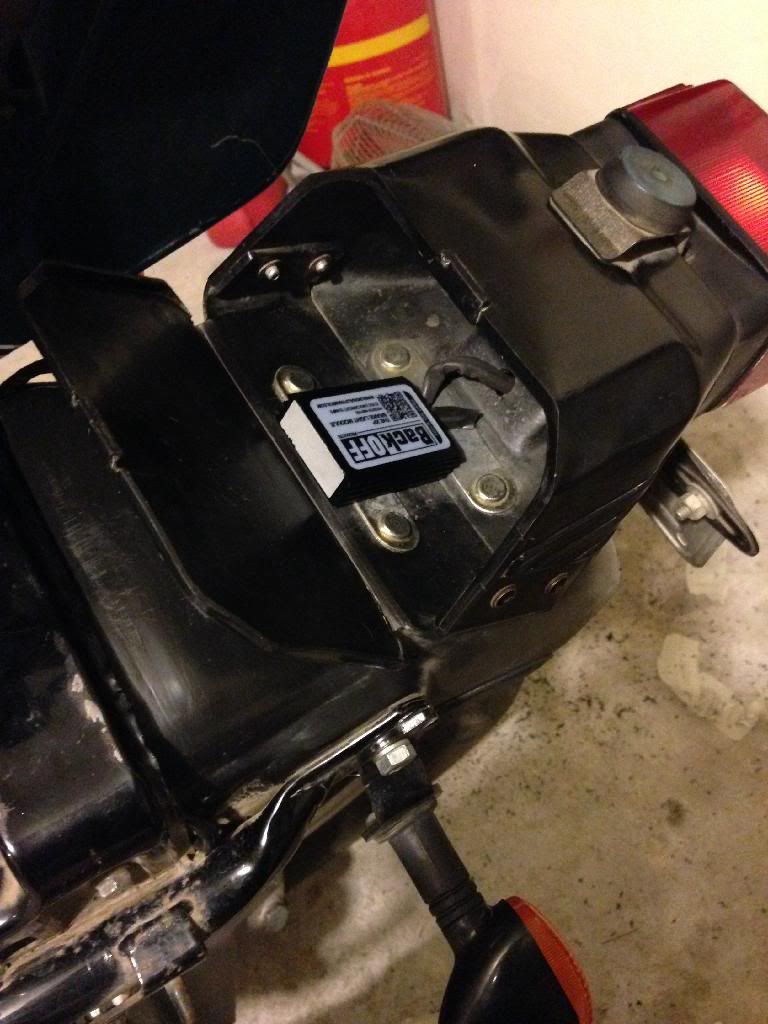

    Also got a brake light modulator:
    Carbs spotless! I still have to buff them a bit on the exterior.
    Front running lights with smaller signals, and all new cables.
    Any thoughts or suggestions? I'm headed to pick up a seca turbo oil cooler tomorrow! Stoked on that...

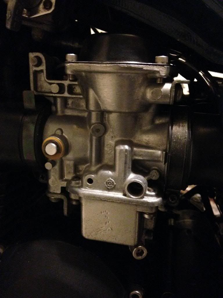

    Having some issues...
    Okay, so after this whole carb rebuild thing was over, I started fine tuning. I got a colortune from Chacal, and started tinkering. I realized my damn #2 carb is still acting up. I could not get it to go "blue" even with the mixture screw all the way tight. It get's to the edge, but will not go far enough to bunsen color.
    My thoughts are: leaking enrichment choke circuit/incorrect float level/leaking float/sticking float needle/pilot air jet or fuel jet located backwards.
    How should I test the enrichment circuit for leaks?
    Anything else I should look for? I think I'm going to start from the beginning on this one: Test compression/check valves/vacuum sync/colortune.
    Anything I'm missing?
  25. FtUp
    FtUp Well-Known Member
    1,309
    94
    pacific northwest
    possibly just a high float level? did you wet set them? do a quick on bike check before you tear into anything.
    CN
  26. lacucaracha
    lacucaracha Member
    359
    Napa, CA
    I'm thinking enrichment circuit not sealing well, as per a PM with Len. I'll be digging into them this evening to scope it out. Nothing is leaking, and it fires constantly as the colortune indicates. It wouldn't run that close to "well" if it was the float level. I checked the level wet twice. 2mm down on that carb according to my notes.
  27. lacucaracha
    lacucaracha Member
    359
    Napa, CA
    Got everything dialed in! Holy hell, it runs like a dream. I polished the enrichment circuit valves, adjusted the floats so they don't hand so low, and removed the screens on the float seats. For now, it is perfectly tuned.
    Next order (next paycheck) from chacal is the little screens, then I'll ride her into the sunset.
    Thanks for all the help everybody!

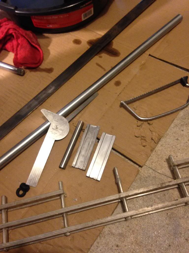

  28. lacucaracha
    lacucaracha Member
    359
    Napa, CA

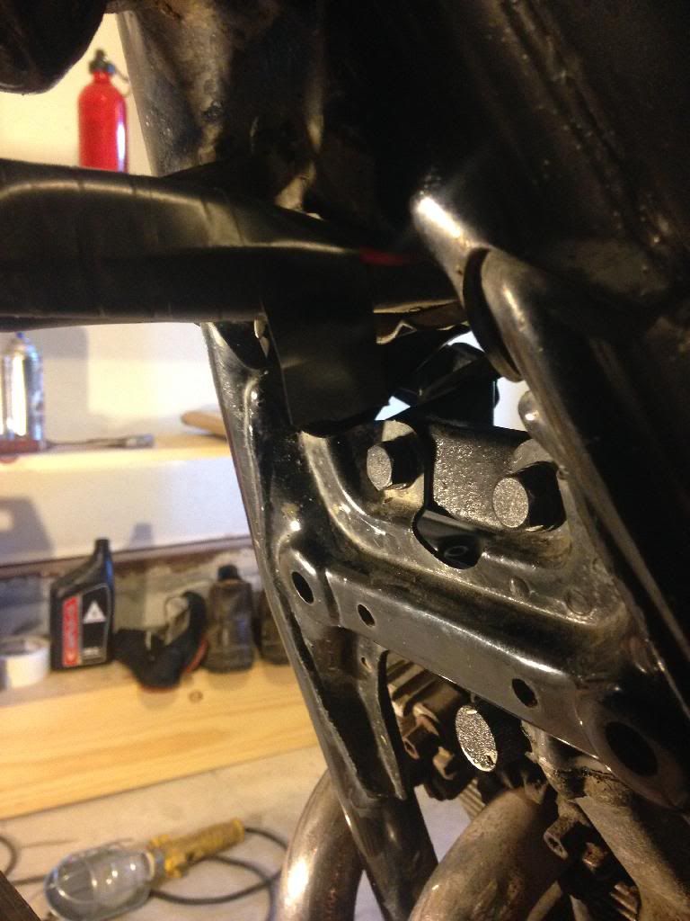

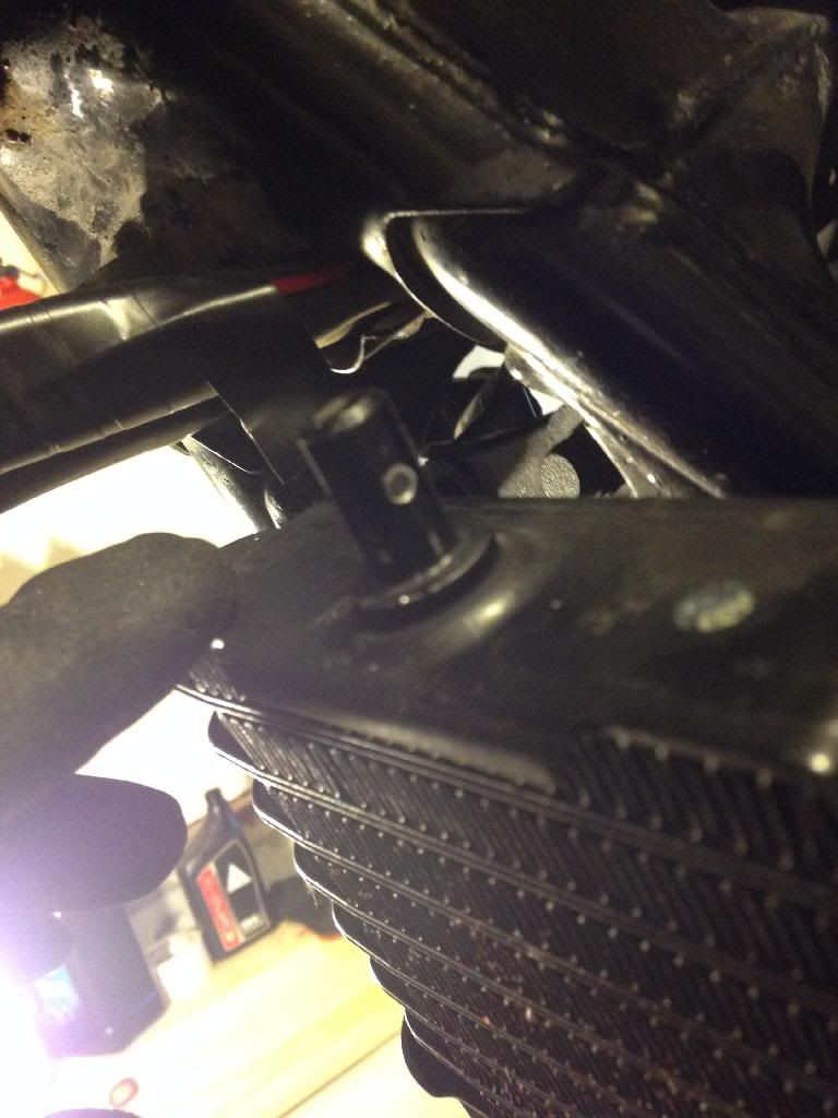

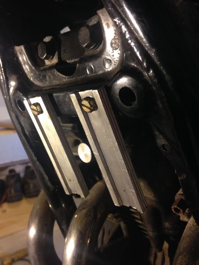

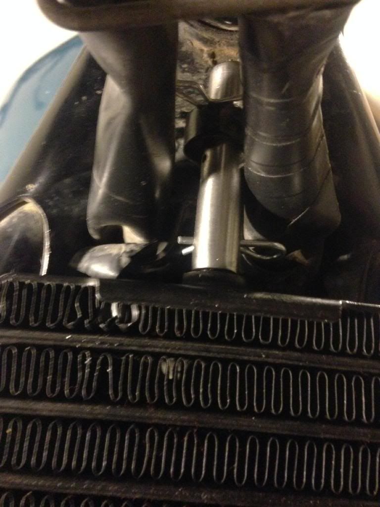

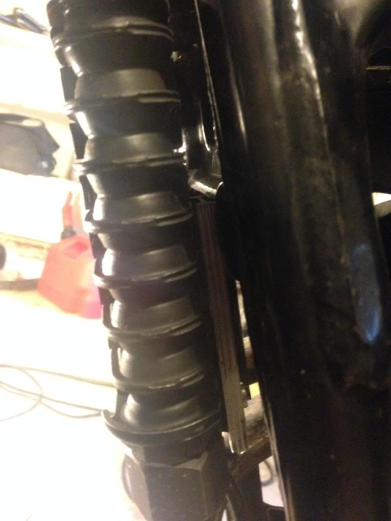

    Got my oil cooler installed. Used two peices of aluminum, and a stainless tube up top. Worked out okay, and hopefully the red thread locker will hold it together. It seems pretty damn solid as is.
    Before
    The aluminum. It's off an old walk way.
    Mounted up top...
    And down below...
    Drilling out the upper mount for the tube.
    And the final upper.
    I think I want to replace the upper pin with a rubber sleeve. The lower pin holds it on, I just don't want it to rattle.
    Next step is building a guard for the cooler. I have the lower mount, but the hoses don't move at all, so I'm going to leave it off, for now.

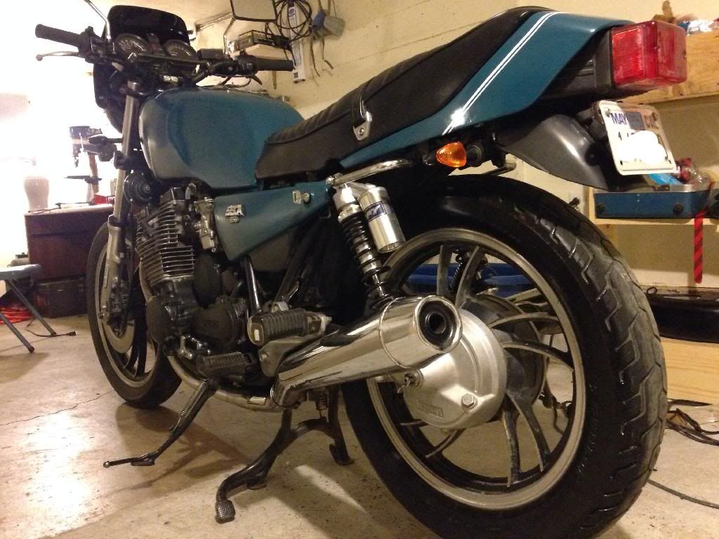

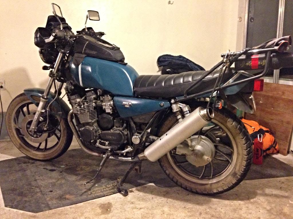

    Okay, been a while since I posted anything and wanted to see what everyone thought about an exhaust idea.
    These cans are off of a Ducati ST2 and are Remus brand, although not aftermarket or anything.
    From the back compared to stock:
    The definitely have a more "sportbike" look. They're about 2 lbs heavier than stock, and they sound almost identical, but are a tad throatier.
    Any thoughts?

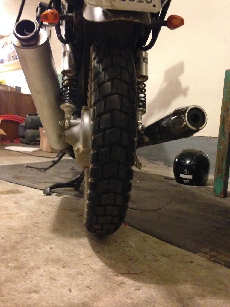

  31. lacucaracha
    lacucaracha Member
    359
    Napa, CA
    Yeah, I saw that tutorial. I'm hesitant to cut them up and have to rejet.
    Here's a pic in a more stock position:
    And just a tad higher:
    They cost $40 so it's not the biggest loss if I do try to chop down the baffles, or even keep them "stock" and shorten the entire muffler.
    Clearance is a bit of an issue when they're down low. A few mm away from the axle nut, etc.
    The other problem down low is the center stand, which I'd love to keep because I use it all the time.
    Function always over form.
  32. Bigshankhank
    Bigshankhank Active Member
    908
    125
    Bastrop, TX
    Do they foul the center stand in both of the lower positions? Of the two positions, I would go with the slightly sportier "tad higher" one. It follows the lines of the cargo rack and side covers better. Plus if you can get the mounts to work, you could find some nice Leo Vince's or Termignoni's in either carbon or titanium, if you were so inclined. I had the LV's in Ti and loved them, super lightweight compared to the stockers.
    Fun fact; The Ducati ST series bikes had two mounting points so one could raise or lower the cans to suit their needs, although each position cleared the panniers (as well as their center stand) so I never understood why anyone would run them in the lower position.
  33. lacucaracha
    lacucaracha Member
    359
    Napa, CA
    Yeah, anything lower than the first pic causes issues. Looking a prices for Ducati aftermarket pipes...holy crap I'm scared! More than I spent on my bike in the first place!
