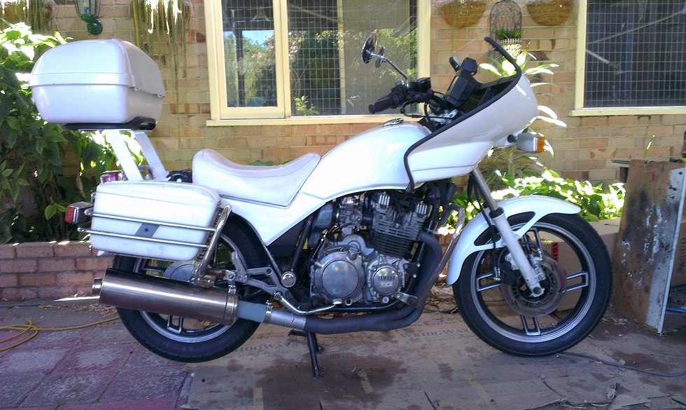

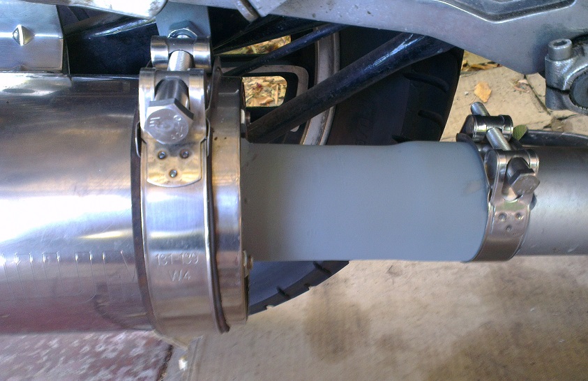

    Came close to the SS scrubbies suggestion but in the end I found this little beautie on gumtree the other day and after modifications it is so quiet the engine sounds a bit like a blender with nuts and seeds in it.
    I have to paint that adaptor and extension the same colour as the 4into1 pipes still but...
    Kawasaki Titanium muffler $30... getting rid of that piercing howl - priceless!
    One thing I absolutely think are the best are these clamps that the exhaust guy, who i bought the pipe from, suggested from enzed. Stainless steel, metric, damn sexy.

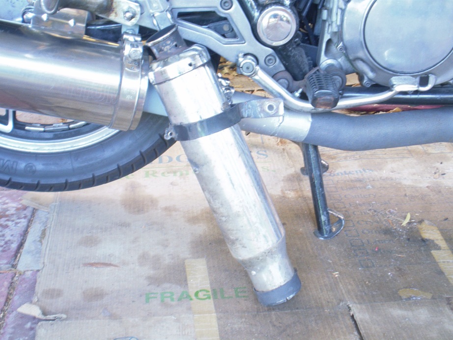

    This one. Pipeline I think the sticker reads. Pretty much straight through if you look inside it.
