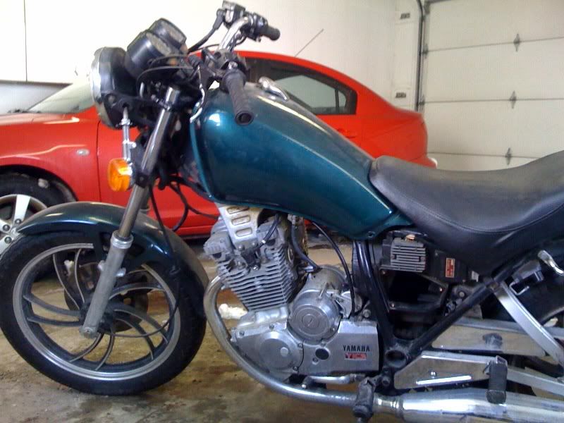

    This is her about 2 years ago (this has been a long time in the makin!
    Since then, I had taken her to a mechanic and had the tinkerbell sticker removed (hah ya ya..) and had the bike tuned up...
    Lately (last month or so) have been slow as im a little spooked about the whole 'Gear head" thing... this aint no computer!! :p hah.
    here she is with the carbs out (which were freakin spotless after a year and a half of not having them cleaned) and the front end lowered by an inch or so (i think its technically an inch and 1/8th - couldnt get it exact with just me doin the liftin and adjusting)
    I have filed down some foam in the seat and plan on hackin it in half... still not funny certain on the remount (originally it bolted onto the back frame which supported the fender, "trunk", and sissy bar (you can see it in the first pic what i mean i think) - im pretty certain the way i got it planned is that it will be able to screw into two side holes in the frame... ill get somethin drilled through the frame too.
    you might ask about the lowering reason - its basically to get the missus (who is pretty short - 5'2 i think?) to get on the bike to try it out.. with the seat foam filed, and the front lowered that (what other posts stated as a..) safe inch - im hopin it will work for her
    im also the guy who posted about the single spring in the center of the bike under the spring - and how to lower it... if it comes to it, ill email that guy on ebay who will cut it short for me for 70 bucks (i think it is)

    Suggestions: The seat height is probably low enough; don't mod the bike too much and then put a novice rider on it.
    I would NOT cut down the monoshock; put it at its lowest preload. You REALLY don't want to mess with the monoshock geometry; if it were me I'd actually drop the forks back down 1/4"-1/2" That bike wasn't very "tall" to begin with and as much as you've lowered it will change the way it handles; unfortunately not for the better. I'd put it back a bit.

    maybe i will bring it up a bit.. to about half.. should be easier when i have someone to help lift it. i thought about takin it for a spin myself before i let her rid it tho - you know - test flight!
    i filed down the seat more actually before i read the reply, but it looks ok so far, and with me putting it on the bike as a mock up - fits my posterior pretty good (hah)
    before any lowering or filing, she could barely keep a toe on the ground of one foot, so somethin had to be done, and she wont by a perfect sized c50 :(
