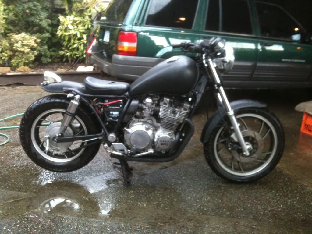

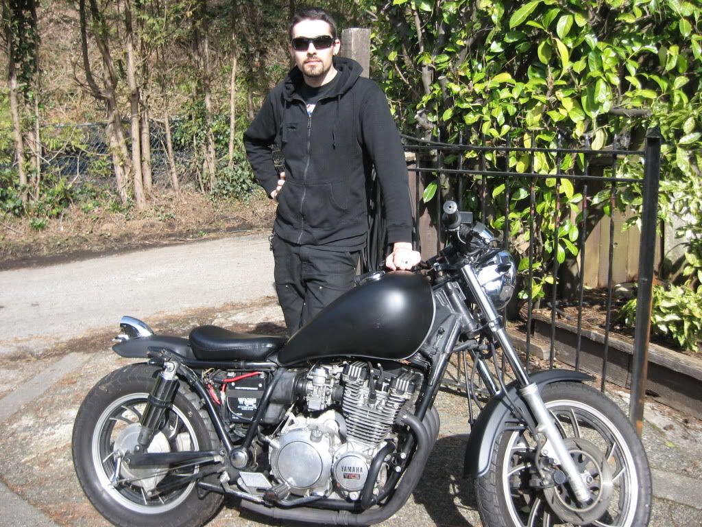

    83 Maxim 750. About 80% done with my preliminary bob. I don't have a garage so I am just hacking it this year, will fully strip and rebuild when I have a roof and storage space...
    Where she started
    Where she sits now

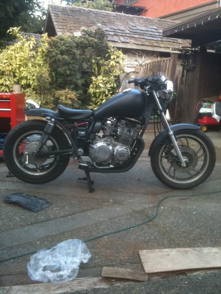

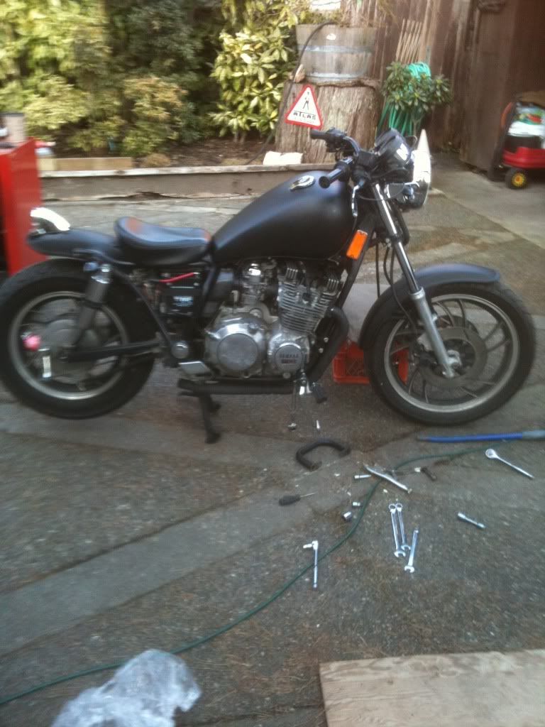

    Got some work done this weekend.
    Did the forwards, but I didn't like them so I reverted back to stock (this is why you try before you chop :p)
    Got my seat fabbed up from an old pillion seat we had in the shop, still need to attach the leather to the pan.
    I got my pilot circuit rebuilt but she still runs like ass. No power in bottom end, good power mid and high. Seems to be running super rich. Looks like I may be pulling the carbs again to see what's going on...
    Any on bike advice from the gurus would be appreciated.
    The jetting should be fine as I ran this setup last summer, just swapped my jets to a new carb this year. Tried playing with the pilot screws. Is rich all through but mostly poor below 2-3K

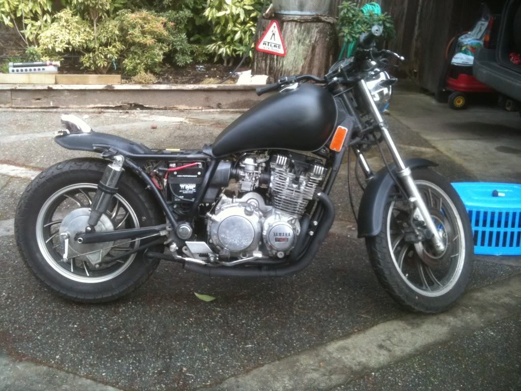

    Got her running propper this weekend. Apparently I flipped the Air jets (the small jet is the Main Jet... go figure :roll:
    So after a new set of plugs,flipping the jets, and some fine tuning she is running like a dream.
    Re-upholstered the seat properly and fabbed some mounts. Worked out nice for me.
    Tried the scrubbie in the exhaust silencer technique. Works pretty well but they blow out the back when I really lay into her. Anyone done this successfully? How'd you keep them in the pipe? I think I'm gonna try to put a small bolt downstream which'll reduce the I.D. enough to snag the scrubber.
    Here is where she sits after a little cleaning...
    Anyone know how to get a ton of fresh and burned oil off of the cooling fins behind the exhaust pipes?

    Hey, personally I like the look you have created in your bike-very original with a real down to earth solid look. I just bought a XJ750R Seca 3 weeks ago. First thing I did is take off the fairing and Vette boxes on the rear. I am already liking it more:))))) Being an old school Jarhead there is something to to be said for plain and solid reliability. grunt007

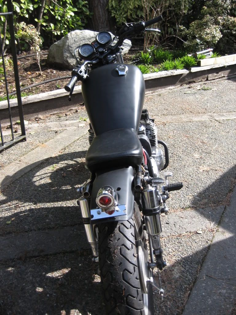

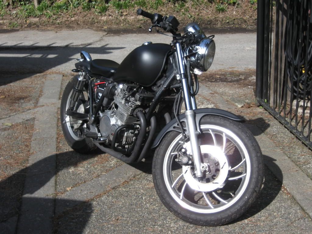

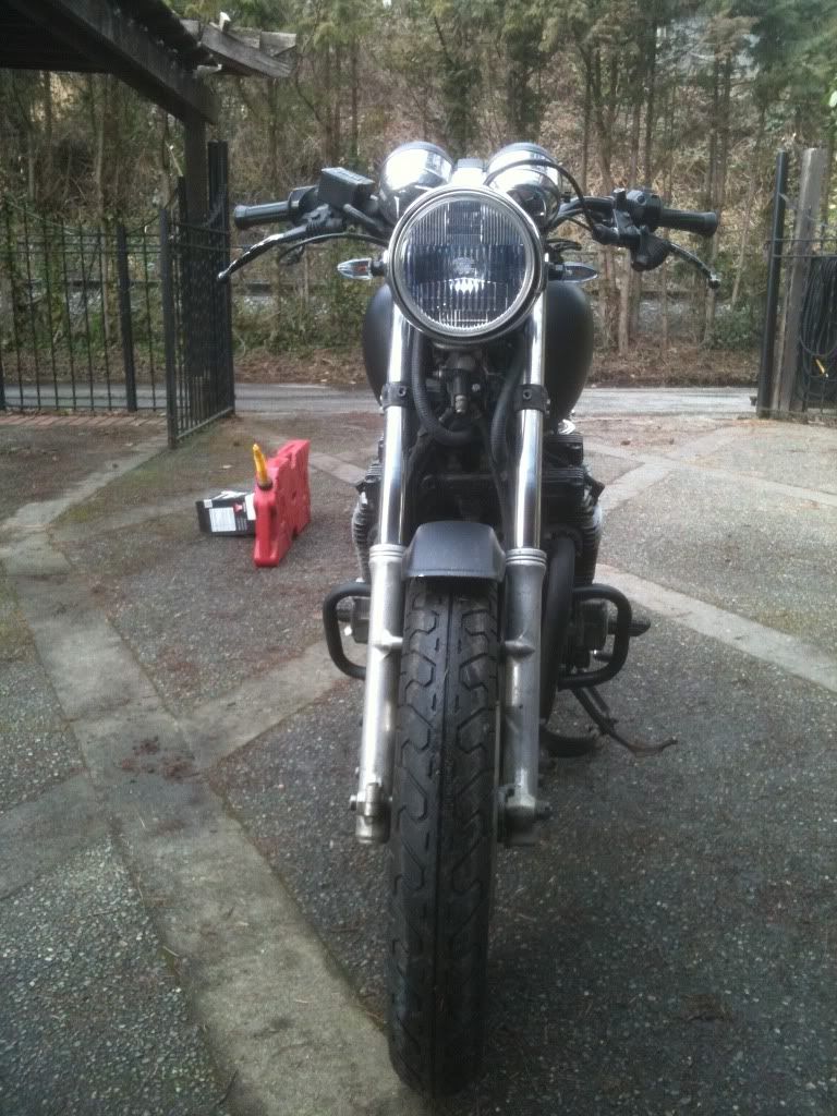

    So we had some sun today, I decided to snap some proper pictures
    Front of the bike
    Rear of the bike.
    My license plate will mount under the tail light where you can see the two bolts.
    Side shot. Still need to build some side covers...
    Front looking back. Need to clean up the pipes. Must've gotten some grease or something on them during assembly...
    Me and my baby

    As promised, here are the photos of my new mirrors.
    I like them a lot. The arm mellows out any vibes I get and also means that when I am just cruising I can have them flipped down the way I like but when I am pushing the bike a bit I can flip them up to more of a traditional mirror placement.
    To solve my flasher issue I got an electronic relay, will be wiring it up as such in the next few days and we'll see if I can't get them to work at idle...
    Will let you all know how it goes as I hope to keep the auto-cancel feature intact...
    Cheers
    Dave
  38. -Azrael-
    -Azrael- Member
    167
    Vancouver, Canada
    So the flasher didn't work. I did happen to have an HD-13 kicking around though which did the trick :)
    Also got some pipes on her today. Really happy with them and the new deeper sound. They were some Cobra Longshot silencers adapted to work.
    Also have to realocate the license plate as I got tagged by a cop for having it too level. Think I am just going to add some brackets to bring it back so I can tilt it...
    Cheers
    Dave

  44. -Azrael-
    -Azrael- Member
    167
    Vancouver, Canada
    Just an update becuase I'm bored :p
    Got some dragbars on her
    Working on forwards and ignition relocation right now
    Cheers
    Dave

    A few new changes.
    I swapped my rear shocks for some chopped ones (thanks zookie!)
    Before:
    After:
    I'm pretty happy with the looks but also I like the ride better as it feels like it suits me a bit better having the nose feel higher.
