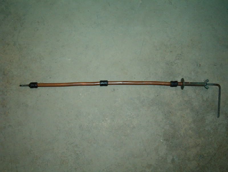

    I made this one a few years ago and it cost about $4 and took 20 minutes to make. It isolates my carbs good enough to get a good sync, but then again, some people just don't believe in them. -Nick

    Yours looks good for $4 and 20 minutes invested!
