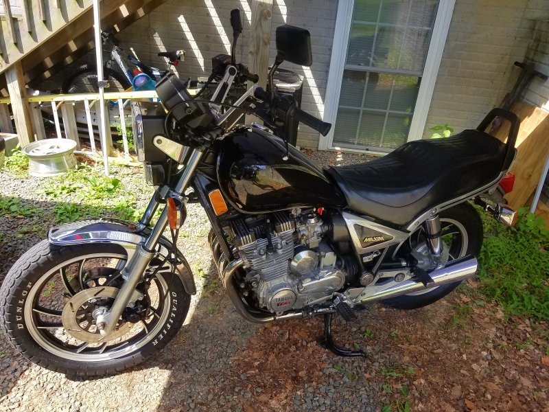

    My stock 1982 XJ 750 Maxim J
  1. Bluestar
    You’re missing the “YAMAHA” gold emblem on each side of the tank, it makes the bike truly stand out, you’ve don a great job.

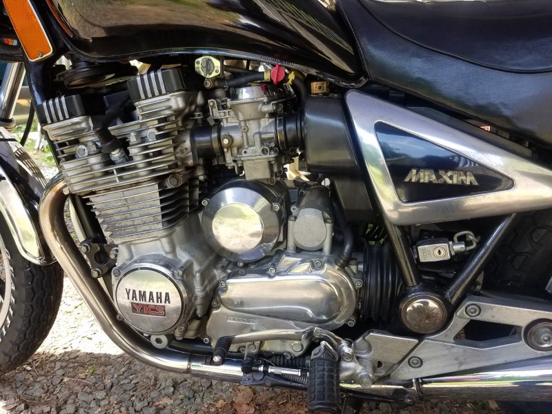

    Hi, I'm new to this site and to motorcycles, I Think I may have The plug wires on the wrong plugs. If you can could you tell me the order the plugs go.
    1. DomG too the max
      Hey good evening j7st a note to let ya know the wire routing on an xj 750. If you are sitting on your bike left to rt it is 1outer 2 inner 3 inner and 4 outer this is the rt order hope this helps you im going out on a cruise now its nice out have a great night!!
      DomG too the max, Jun 3, 2020
    2. Bishop30
      Thanx man that helped alot. Running smooth and no irregularities.
