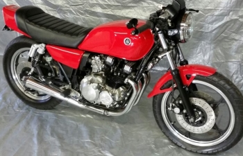

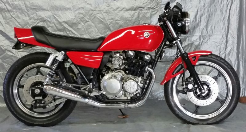

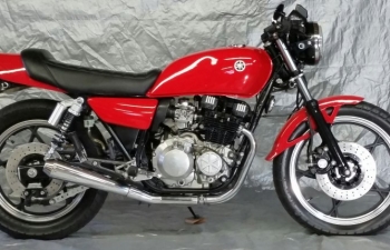

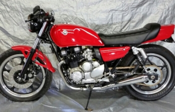

    Modifications & Accessories:
    -Rear sets and handle bars fabricated.
    -Fuse box upgrade.
    -Factory seat reshaped, width thinned almost 3", and reupholstered.
    -Lowered fuel tank in front 1 1/2".
    -Swingarm swap off of a 1993 XJ600,width tightened 1 1/2" to fit suspension mounts.
    -Steering damper with fabricated mount.
    -House of Kolor red paint.
    -145 MPH speedometer in lowered factory cluster.
    -XJ700 engine side covers.
    -Euro wiring harness replicated.
    -XJR400 SS header pipes, NOS collector, reverse cones w/ SS wool packing.
    -HYPERPAK FlameThrower TCI unit.
    -AGM 14AMP battery.
    -2003 CB750 coils w/ 8mm plug wires.
    -RFY rear shocks. (modified)
    Front set up:
    -Lowered 1983 GSX650 air forks, brake calipers & 19" front wheel.
    -Progressive springs.
    -1982 KZ750 drilled dual front discs.
    -1983 GSX650 front fender.
    Rear disc brake set up:
    -2002 R6 master cylinder & reservoir.
    -1998 Bandit GSF600 caliper.
    -1983 GSX750 18" rear wheel.
    -1982 KZ750 drilled disc.
    -Fabricated brackets,caliper stay & brake control bell crank.
    Built not bought, $500 Craigslist find with 8000 miles. One owner.
