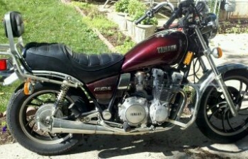

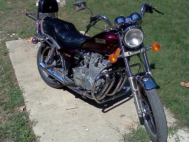

Sarah's '80 Yamaha Xj650 Maxim
Average User Rating:
5/5,
  • Year:
    1980
    Make:
    Yamaha
    Model:
    XJ650 Maxim
    Engine Size:
    653 cc
    Modifications & Accessories:
    Hella H4 headlight conversion
    6 blade fuse block upgrade

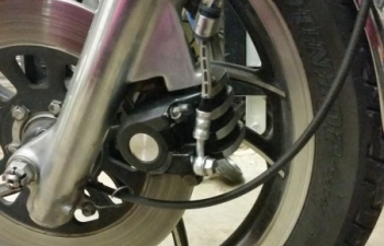

    SS brake lines, rebuilt master cylinder, rebuilt caliper, & new pads & shoes
    SS clutch and throttle cables
    Rebuilt carbs, new intake manifolds, new fuel petcock
    Progressive Suspension 418 series adjustable rear shock absorbers
    Rebuilt forks, with Progressive Suspension fork spring kit
    All Balls tapered steering head bearings
    Slipstreamer SS-28 Sport fairing
    Lindby Linbar engine guard
    Cortech Super 2.0 saddlebags
    Castle saddlebag supports
    Tourmaster Cruiser III tool bag
    KG Engineering luggage rack
    Kuryakyn helmet lock
    Kuryakyn LED 'tri-light' license plate frame
    LED accent lighting & LED turn signal side mirrors
    Akron cell phone mount
    Eklipes power port
    Go Cruise 2 cruise assist
    Michelin Commander II's
    + necessary replacement of wear items, spark plugs, air filter, fluids, gaskets, bearings, etc.. and hours and hours of cleaning and polishing aluminum!
    Acquired in 2012 in very good original condition; one owner, 6,454 miles, all originally included accessories and documents (toolkit, security chain with instruction tag, owner's manual, Yamaha "owner's card", original title) all nicely packaged in the original dealer paperwork folder.
    Since then, we've lovingly restored, repaired, upgraded and customized into such an awesomely fun, reliable, incredibly peppy little bike that I am in love with, and will hopefully never have to part with.
    Even though it's taken 3- 4 years to get here, I've been able to ride the during the entire process, amassing another 10,000 miles so far. My bike has never left me stranded.

    1. Sarah
      I absolutely LOVE the progressive suspension 418 series shocks! They make a huge difference over the stock KYB's. Much better performance and handling, and I love all the adjustments. Really sucks they discontinued the 418 series. I got mine slightly used off eBay for a great price, they were technically for a Sportster but the correct spring rate and everything. Just needed slightly larger bushings.

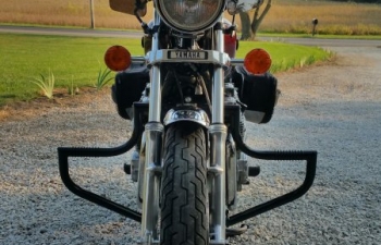

  3. 83Max
    The engine guard / crash bars you have are Lindby Lindbars? Are they xj-specific, or did they require modification? I've been looking for something similar but have only found "universal" sets.
      Sarah likes this.
    1. Sarah
      They're universal, a local bike shop made the brackets for me

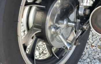

  5. dowski68
    How did you get the rear drum brake so clean and shiny?
    Mine is in desperate need of attention along with front forks
    1. Sarah
      A lot of time and elbow grease! Lol ;-)
      and I found something called an abrasive ball at Harbor Freight, it chucks into a drill, looks like a bunch of green scotch brite pads.
      It helped make quick work of the polishing, between that and the aluminum polishing kit I also found at Harbor Freight we were able to get everything nice and shiny again.
