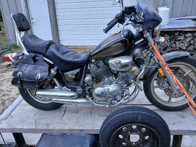

    I told myself I would never work on another Virago 750 or smaller. Just the way the starter system works with those bikes and the last of power.
    So good old market place gets me again. Less than an hr drive and she is at home on the trailer. More to come.

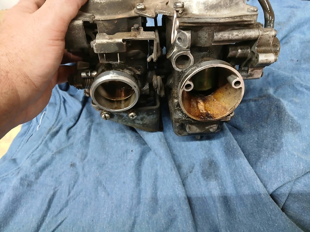

    Them carbs. If you have not removed these carbs before, take your time. Watch some vids and have really good fitting wrenches when it comes to the 10mm bolts that hold the carbs to the heads. It took me a bit to remember how to do them, then it started to click. The 10mm were already in bad shape from the PO or someone trying to clean them. Had to pound a 3/8 wrench onto the stripped porting and they came lose.
    [​IMG]DixJcFd0 by Tim Brown, on Flickr
    [​IMG]DLh1SbJe by Tim Brown, on Flickr
    Just look how now and clean these bowls and jets are. Should take only a sec to clean them, lol. I have never had a bowl with that much junk in the bowl. This is a fuel pump bike, I am guess this is why.
    [​IMG]8tjwDq8t by Tim Brown, on Flickr
    [​IMG]AUIWv4lJ by Tim Brown, on Flickr
    On a lunch break with some of the parts soaking. The float jets have the rubber parts that should turn off the fuel, have to order new ones. Besides that, I should be able to clean and save all other parts and jets.

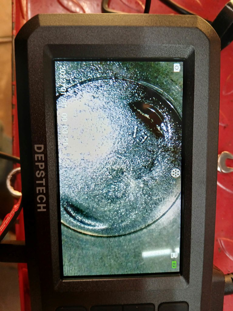

    Carbs are in and the bike is trying to start. Checked the valves before I put the carbs back on. Hmmmm, would could it be? Good spark, got fuel, oh ya that third thing compression. That is what what is needed to make a bike run. 152 on the front cylinder and about 5 on the back. Those rings are frozen to the piston. Here are a few pics using my bore scope of the rear cylinder. The walls look good and so does the piston besides all the carbon buildup.
    https://flic.kr/p/2sGQdrn
    [​IMG]48_yzhHQ by Tim Brown, on Flickr
    Have the 50/50 sitting in there now, keep checking to make sure it is just not running through. Drained the oil and left the plug out just in case it was running right by. The second fill already has the liquid sitting on top of the piston. Used a small clear tube to measure what was on top of piston. I will give it a good day, rotate motor and then check again.
    No wonder the poor old thing just would fire up and then die each time, only one cylinder even trying to work.
