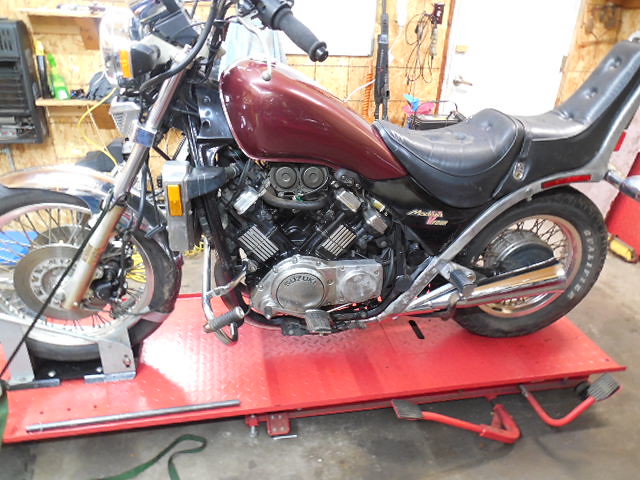

    Was going nuts trying to find another project. I have been itching to get back into another V4. So happens that two in my area came up on market and I grabbed them both. Good thing, as one turned into a parts bike so the other could be almost factory.
    [​IMG]DSCN0018 by Tim Brown, on Flickr
    [​IMG]DSCN0019 by Tim Brown, on Flickr
    You can see from the one pic, the bike must have fallen on a trailer at one time. Could not explain the dent in the tank that way without it falling onto a cross member or a trailer.
    The carbs are these are interesting. Not like the V65 Honda, much easier to get in and out of the bike. You have to remove the intake side of all the carbs to the heads to make it easy. If you don't good luck.
    Carbs were not to bad, but if I didn't have the other parts bike, I would have had to order the little cap that covers the vacuum slide pin. Removing two of the four and they stayed in the hole. Easy enough to get out but still a pain.
    Clutch master was a beast to bleed. If you can see the MC, this design has a nice place for air to get trapped, so bleed can be time consuming. I tried to reverse bleed it and still nothing. Let it sit overnight and a vacuum bleed and it worked.
    Front right brake line was plugged. All OEM lines so they are dated for sure. Rear brake is a cable system, needed some Blaster to make it move more freely. Rear brakes are good, glue is intact. Cleaned and greased the rear hub, all teeth look good.

    The tank inside turned out good. Great think about the fuel sensor is its the dry or wet type sensor. So, wet no light, dry turns the fuel light on. Second tank is also looking good. It is a black one and might get put on the bike in pic. No dents but could use some paint. I will get to the bike in pic this week and do a shakedown ride. Looking forward to seeing how the V4 sounds and what kinda of power the 700 cc has.

    Shakedown ride went okay. I had to make it short, brakes were not being brakes. Besides that, bike has very good pull, feels good shifting through all the gears. Engine is strong! Now I still have to do a few things. The lights for the oil and neutral light are not working. It is not the lights, check that already. Have to start to look at the switches or, they will start to work once I do a good oil change and put some sea foam in there to break things up. I would guess the oil pressure switch might be just gummed up. Looking at another project bike this afternoon. It is getting closer to winter here in Wisconsin, got to have lots of projects to keep busy in those nasty cold months.

    Found the issue with the lights on the instrument panel. A few were working but the Oil, side stand and Neutral lights were not lighting. One of the common connectors in the gauge harness had a bit of corrosion. All fixed now.
