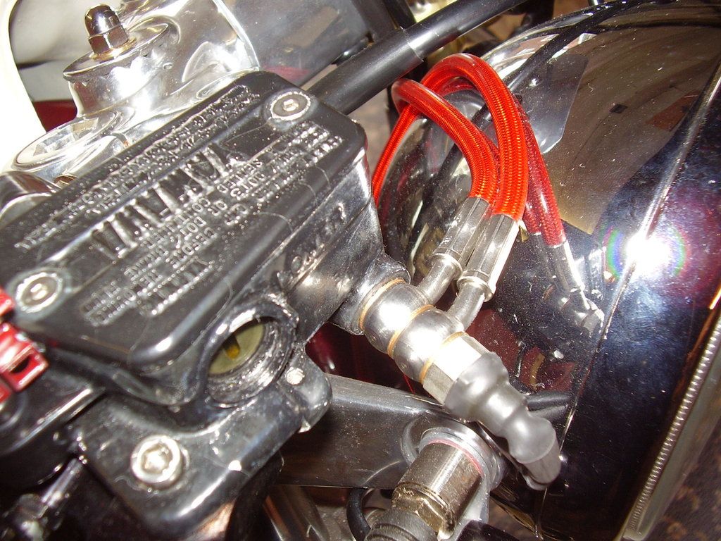

    you could use two hoses rather than three, sometimes it's cheaper that way.

    Hey Polock, have you ditched the splitter and just used two hoses with a dual banjo bolt at the master cylinder (or do you know someone who has)? I was wondering if this would work or if the splitter is required.
    splitter is not essential, I ran 2 s.s. hoses, instead of 3, as for the dual banjo bolt , I used one that incorporates a brake light switch working on brake pressure.
    system works great, and you are only paying out for 2 hoses not 3
    stu
