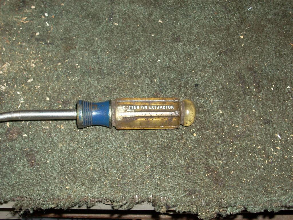

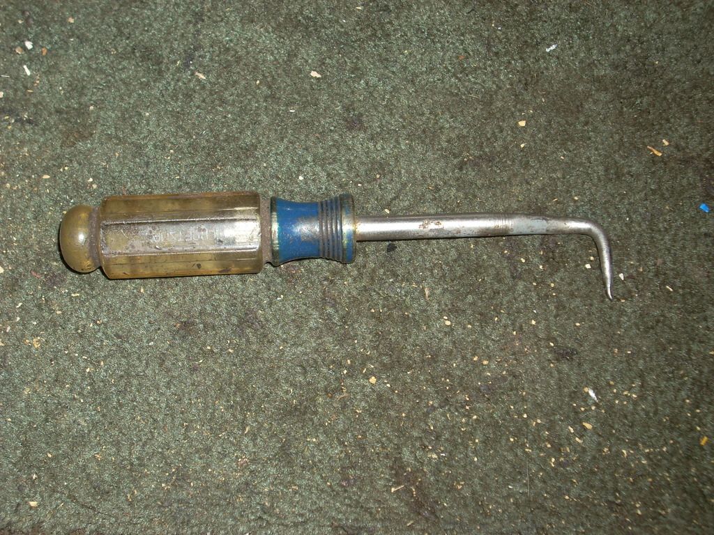

    I have an old pick with the last inch bent at a 90 degree angle that is really helpful in getting the boots on the carbs.

    It's actually about the size of a medium screwdriver with the end ground to a point and the end bent about 90 degrees. Don't know where I got it but it would be easy to duplicate. I'll take a picture tonight and post tomorrow. It really makes it easy to get the boots, especially the two in the middle, to slide on the carb.

  16. tabaka45
    tabaka45 Well-Known Member
    2,413
    521
    Brunswick, Georgia
    Official name is a cotter pin extractor
  17. hogfiddles
    15,112
    5,355
    I hav one of those....and use it for this purpose! It's one of my favorite tools in my pouch
