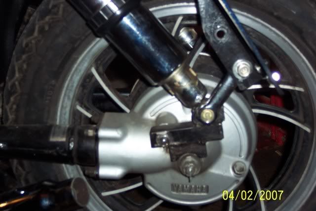

    I dropped the rearend of mine by making shock lowering blocks. They moved the bottom of the stock shocks back 3" hense lowering the bike quite a bit and keeping the soft ride.

    Here's the right side shock extender I made out of 1"x3/4" solid square stock with a U-shaped piece to mount the bottom of the shock to (a little drilling, cutting and alot of trial and error to get it where I wanted it) The mounting bolts are exactly 3" apart.

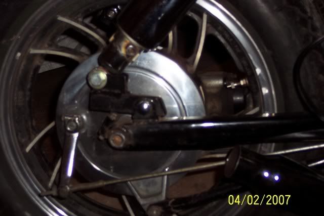

    Here's the differential side. The mount had to be made a little different because of the rear housing. I had to fabricate a brace on the bottom for the extender to rest on. That chrome bracket is the license plate mount off the rear shock bolt. This side is made out of 1" heavy-wall hollow square stock with a U-shape piece for the bottom of the shock to mount to.
